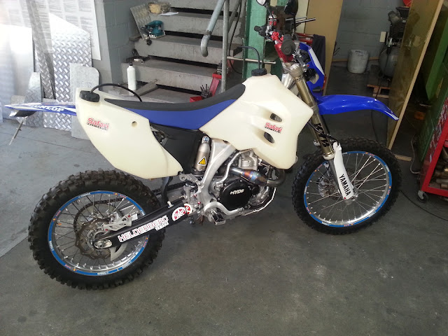

The tanks arrived and I fitted them :
and from the back, sexy! :

The rear tank acts as a widened seat :
I really should have upgraded my seat, it caused major fatigue.  After massive liasons your bum gets so tired, then you tend to stand to fix that problem and that causes sore feet and knees.  The bike was kitted with extra wide pegs, so that helped a bit.

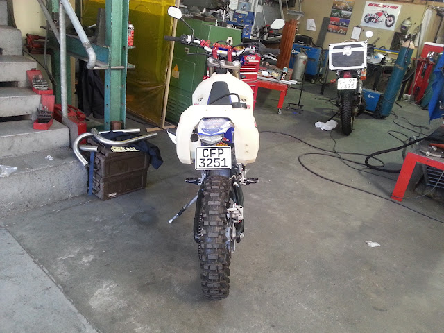

Routing the exhaust was a bit above my skill level(which is none), so I consulted my trusted friend Arrie from Scorch(now Beserker) exhausts/canopies to help me with this task.  It took him a good part of 15 minutes to do this!?! Crazy.  We used a picture from an Australian Safari bike with the same tank setup as a reference.  In fact, it showed us how we don't want to do it  ;D  :
Lets see how it fits along the tank :
Arrie ducking for a profile shot to see if the lines are right :
Tacked and fits perfectly, exactly like we profiled it :
Crazy routing skills! :
Very close to the fuel line, but we will make a plan later :
Exhaust with tank combination :

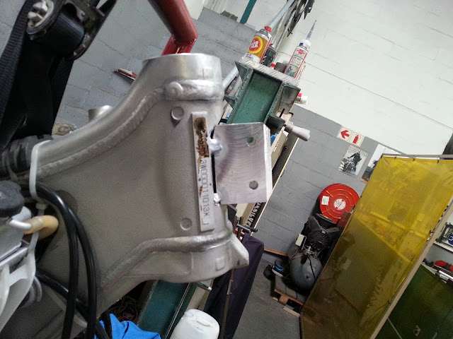

Next step is to manufacture a bracket.  After a few lessons from my friend toolmaker Reynard, I started milling! This was my first time, but I had a good tutor :
The finished product.
My tutor measured it and I passed! Less than a 1/10th of a mm out! Nice!  The clamping will be done with some high tensile steel Allen head bolts with dual washers, a split washer and a Nyloc nut!
Over engineered enough!? :
I must admit, I was(and still am) worried about the clamp breaking off the frame when I clamp whatever needs to be clamped.  Whatever goes in between the clamps, needs to be a overly tight fit - we are talking rubber hammer tight.
Another profile picture :
Looking good, now to tack it :
Tacked and ready for the next phase :
Square, phew! :
It should do it. Side view :

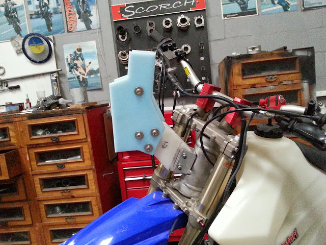

Back to navigation, it is a rallye after all.  With the clamp tacked, I could start profiling my tower and equipment tray.  I started with a base member :
Wood is easy to profile with, and it supports the equipment tray with all the gadgets mounted.  This way I can get on the bike and get a feel for the dimensions.  I am going to be doing a lot of jigsaw cutting, fitting, refitting and adjusting, so hardboard for the main members :
I cut a piece of 1mm aluminium at the same time for the equipment tray.  This was just to make sure that the bender I had could bend the tight angles.  I cut some holes it in, because I wanted to see how everything would look mounted.
The next step was to create a base or main member for the tower.  I used a 25mm piece of HDPE for this.  It was basically a very rough sketch on a piece of paper that I held agains the tower I had built from hard board.  I transferred the drawing to my 25mm HDPE stock.  The milling machine was my new weapon, well, I did not have time to draw parts in Solid Works and get the laser cut.  Good thing, because I made major changes towards the end.  The first rough draught of my part :
I then drew a template of the side members.  I just made it up, with no real plan, but with enough to spare space if I wanted to mount extra brackets or shit on the side :
And this is how you create identical copies :
I drilled some strong triangular spaced hole in the main member and moered it into the clamp(remember, rubber hammer) :

... and yes, it does not look right. Shit! OK, so I did some research, looked at factory rally bikes, just to get a feeling for how far forward this tortoise head of mine can be.  I opened Gimp(linux photoshop) and got working.
MUCH better :
Luckily I gave the main member enough room for the whole thing to move back.

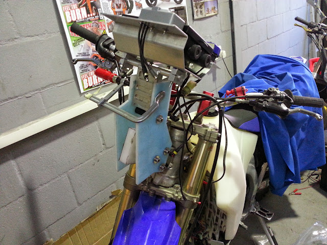

I then did a preliminary fitting of the navigation equipment on the tray :
The g-clamp still in place, as I wanted as little holes as possible in the 10mm HDPE sides :
It is starting to look like a rally bike!  The tower moved back, with all the nav equipment mounted :
Front view :
The main member was too long(mind the pun), so I had to take the tip off :
With everthing disassembled, I decided to add another supporting bolt through the whole tower :
The new finished unit with all the main parts :

Almost done.  I was really running out of time and steam.  It was late one night and I saw a piece of flexible clear plastic in my "stock box".  This is really shit, it was skew, not symmetrical, but I was not going to redo it :
Measuring last year's success, I was going to destroy it on the first day anyway!  It just needed to deflect most of the rocks and sand.
I realised the seat was not bolted in and I was struggling to get it to hook on the tank.  I took of the seat and saw that I forgot to make a little bracket for the tank, so this was born :
Workmanship out the window :p  The little kink is for the loom, otherwise it would chafe against the bracket and short out. I rounded the edges on the sides and surface of the bracket,... just in case.

I dreaded the final wiring effort.  I knew this was not going to be easy getting all that crap in between my navigation tower's side members.
So I took off the headlight :
and started planning the wiring f-up.  Before I forget, check the 2 stainless brackets that the headlight is resting on.  I cannot even remember when I did this, I must have been sleep-bike-building.  I was totally exhausted going into this race, which only put more stress on the situation.
OK, wiring! I relocated the ignition switch and that bought me a whole lot of space :
I jammed everthing in there and used a cable tie and that ribbon wrapping plastic to hold everything in place :
I wired the headlights to the two switches.  I knew they would come in handy.  Don't ask me why.  All I can say is that I thought I knew something about auto electrics... I don't, but this is a area I am going to become a master in.  A new Krog will be born!
