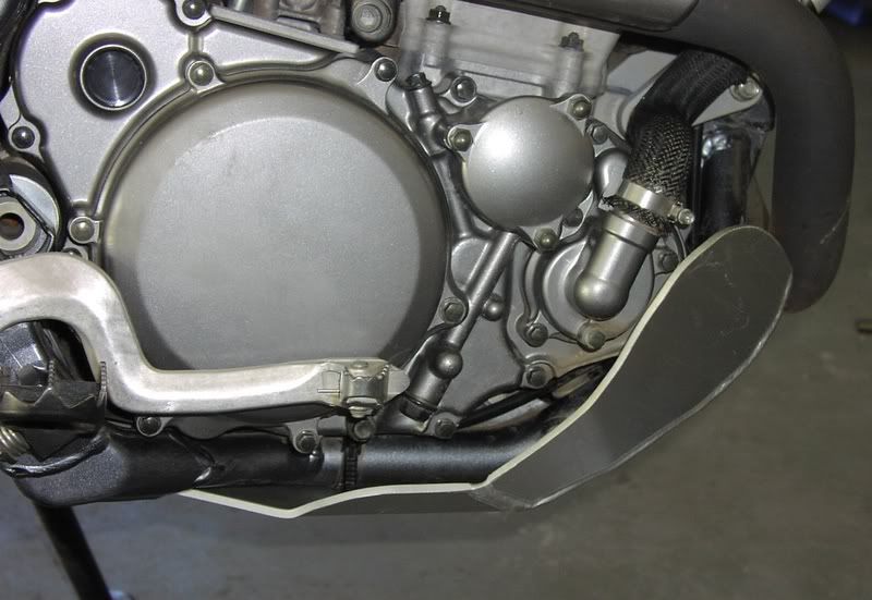

Hyde Developments Skid plate

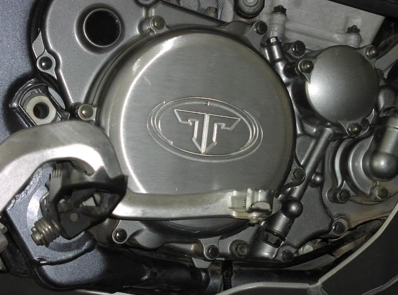

Must say the fun really started with some performance mods. With the help of Runner the Athena 440 kit and a pair of Hotcams really made the bike come alive. But do the cams as a pair, with just the intake it was no where near as good as it is now with the ex cam in there.
To do on any DR -
- file down the back of the shift lever to avoid it cracking the magneto cover
- remove snorkel and open up airbox
- rejet if it's the Mikuni BSR carb
- radiator protection
- bigger tank
- buy or build case savers, stock magnesium covers are thin !
- GET A FCR CARB ASAP !!!
- I service mine every 3000 km, manual says 6000 km

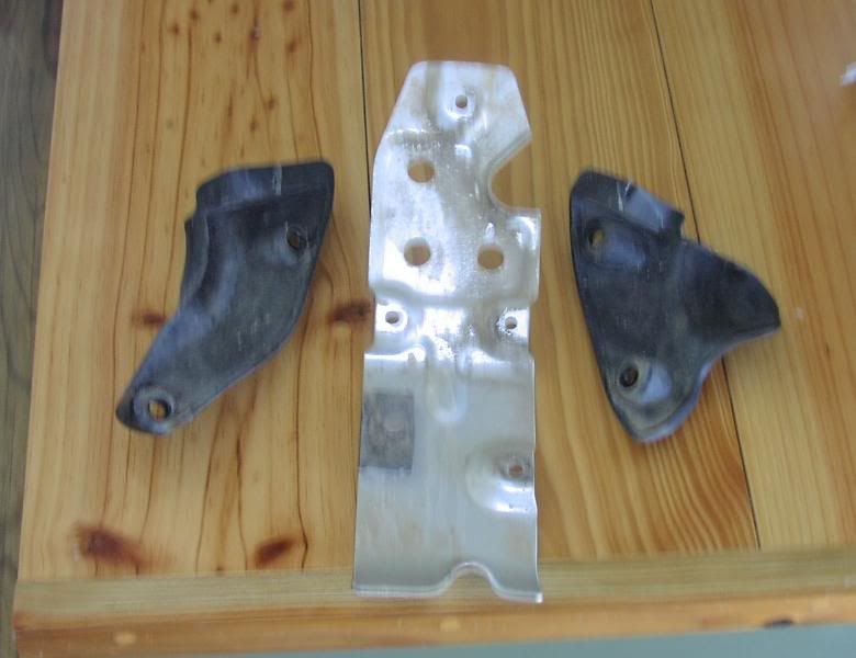

Next was a proper bashplate - here's the original...

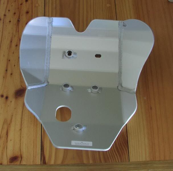

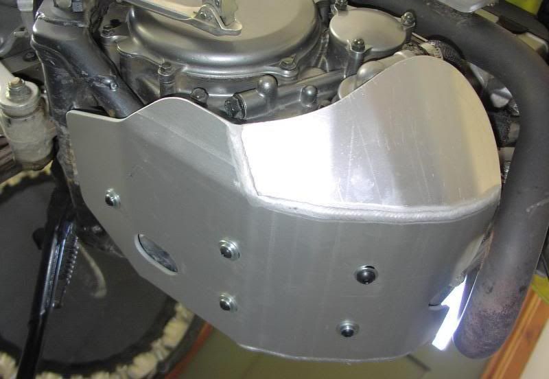

...and the new one...

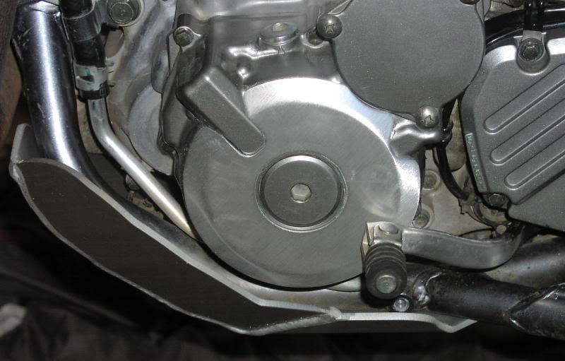

Then some case savers...

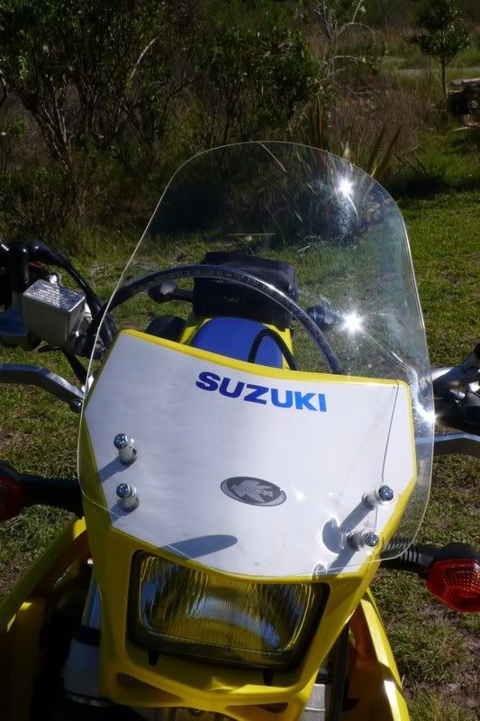

Next a Dakar screen...

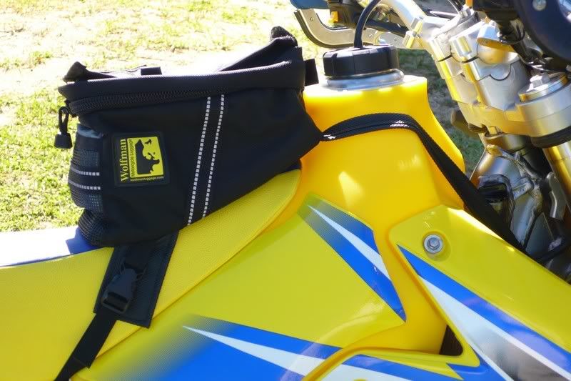

...and a Wolfman Enduro tank bag
