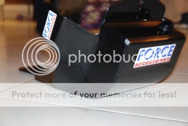

3.   Bash Plate with Water Tank – I have gone with Force accessories bash plate with built in 3 litre water tank for emergency ration as per the FIM regulations. I imported this From Force in Australia.

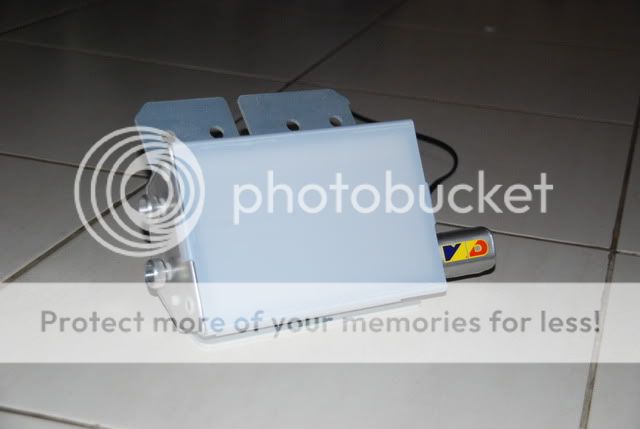

7.   ICO – I found ICO in the USA and they were willing to supply the unit to me.
