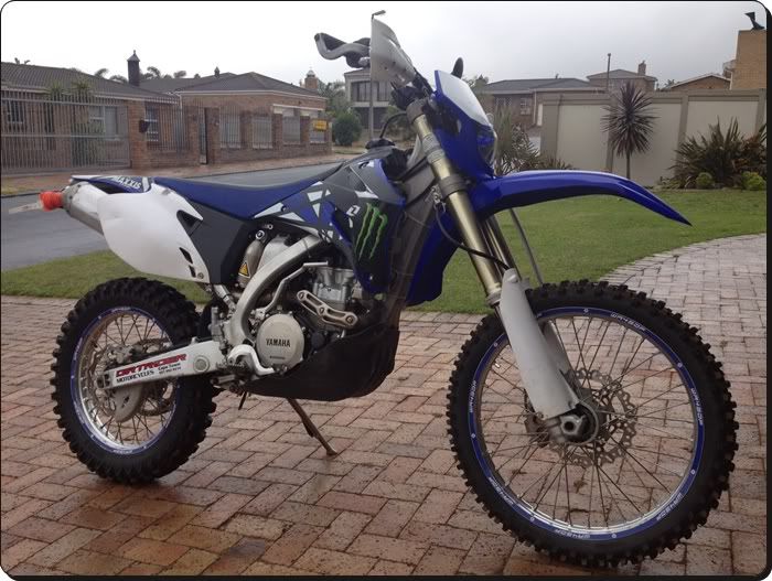

I’ll be riding a 2009 WR450F which I purchased 3 months ago. The bike is stock and came with a new set of Mitas rubbers and a new chain & sprockets in a box.
As soon as it arrived in the Cape, it was sent to Droomers Yamaha for a full check-up and given a clean bill of health after a few minor fixes.

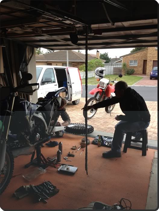

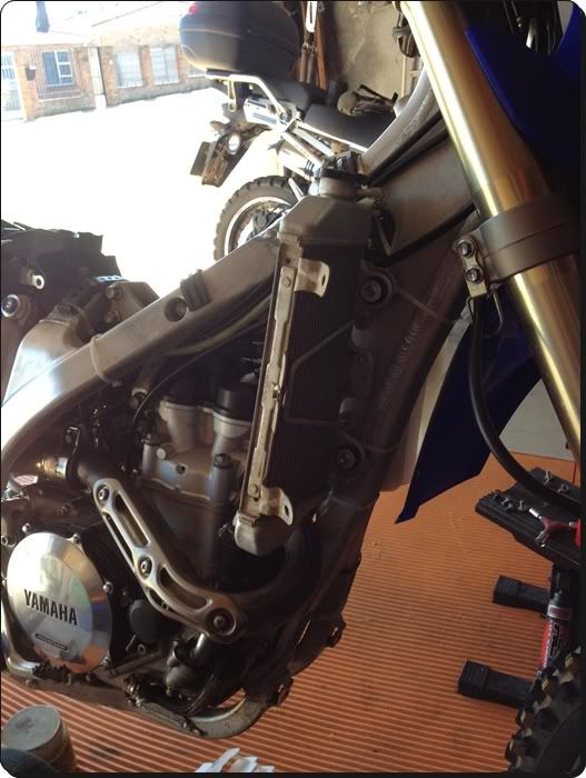

Once I got the bike home, I bought a case of beers, waited for a rainy Sunday and then phoned up 2 of my mates (Adrian & Ian) and we stripped the bike down as far as we could to oil, grease and replaced nuts and bolts where necessary. I need to add that Adrian did the hard graft, Ian the supervision and me the ferrying of beers from the fridge to the garage. We also replaced the chain & sprockets (14 front, 50 rear).
The chances are good that I’ll change the rear to a 47 during the course of next year to run higher speeds on the flat stuff, but for now the 50 works great on the trails around CT. We also added a new set of hand guards as the previous one were looking seriously scuffed.
Ian giving instructions:
It was a seriously enjoyable day and I learned a ton about the bike. Adrian is a Diesel mackie so he knows his way around mechanical things and is willing to share his knowledge. He also has more cool tools than most of us can only dream of owning.

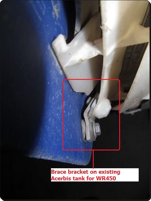

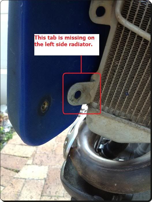

I tried mock fitting it to the bike and found the only negative so far with the bike. A small aluminium tab that bolts the radiator onto the left shroud and plastic radiator protector was broken off, probably from a fall the previous owner had. I had noticed it previously when we stripped the bike but the shroud is light and the radiator secure so it made no difference but now with the long range tank fitted, that tab is needed to provide extra stability for the tank. It’s something that will need to be fixed moving forward. Hopefully I can get someone to weld a new tab on for me.
Broken tab:
What it needs to look like with the tank mounted:
Here's what she looks like with the tank on.

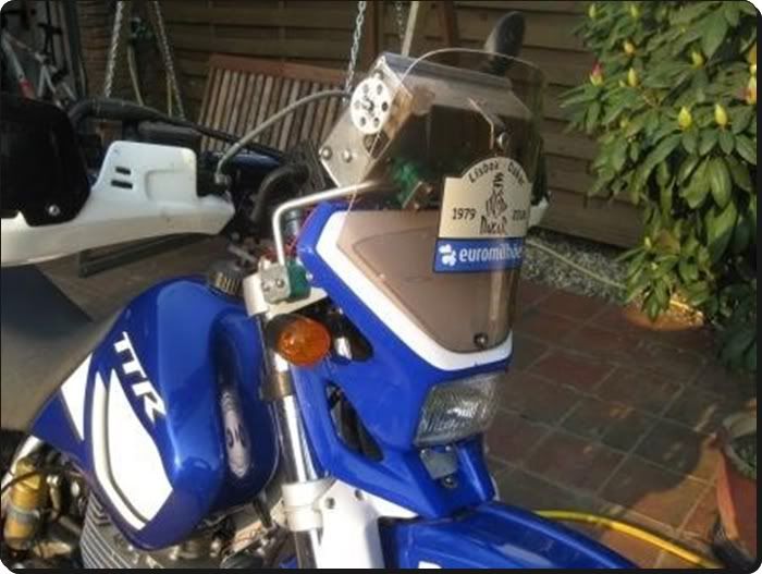

So what else does the bike need for the Amageza:
Besides regular maintenance, the bike’s going to need a few rally components. I’ve identified the following list but it might grow rapidly:
Road book & mounts – preferably auto-scrolling
ICO – to check and reset trip distances to road book
GPS plug point & mounts
Extra Fuel Tanks – The Acerbis tank is 12.6l which will not get me the 250km range that the organiser suggests we need to prepare for. I’ll need to add 2 rear mounted auxiliary tanks.
HID kit for front light – in case I get lost at night
Stator upgrade – to power the extra electrics
Rally fairing – it’s not 100% necessary but useful. I have a screen from my previous 660Z that I’ve already modified to use as a fairing should I not purchase one.
If I can get a setup going like the one below then I’ll be happy.
