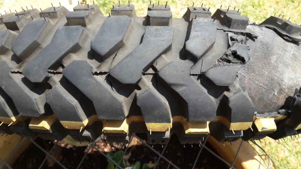

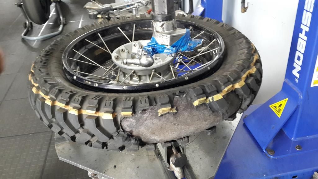

This morning around 9AM we sent off 2x rental GS's and 1 GSA on a trip to East Transvaal
Just when we were readying to go play a round of golf Joe phoned.
 About 80km from when the rentals left the rear Mitas tyre on the GSA delaminated seriously.
 Trudie and I offloaded the golfcart from the trailer and loaded an Anakee tyre in the boot and left to assist them, already waiting at the Petroport on the N12.
 Fortunately the workshop guys at RedStar raceway were present and they could do the swop for us.
The tyres were fitted new on Tuesday and we rode less than 600km on them before handing over to the Clients.
Tyre pressure from the fitting was at 230
But what I am very concerned about is that the tyre was fitted new on Tuesday and has not done more the 700km when this happened. One can see on the closeup the cracks in the tread adjacent to the delamination. The rest of the tyre tread looks ok.
Is this common?

My last gs800adv with 2000km's on them(Tubed)were showing hair line cracks against the Blocks.My last gs800(2013)also showed signs of cracking against the blocks.I love the tyres but it does raise some ? marks.

Interesting. There are a lot of cracks, not only where the failure occurred.
There is an out of the ordinary mark, which I marked in red. I wonder what that is.
Also, doesn't all E07's rear's have the solid strip in the middle? This one doesn't.

went to check mine.. and I also have cracks...
+ - 3000km on them, 100km of dirt,(if that) never seen 150 on the bike (transalp) (usually cruise at 90 -100kmh) and rear is 2.8 as per the transalp owners manual for 2 up.
I have tried to get hold of ktmjedi on roamafrica, but so far I have had no response, so perhaps I luck out here?
Mitas e07
Honda transalp
2.8 rear pressure (rider and passenger)
2. 0 front
Planning an overnight trip with some dirt roads early OCT, so would love to know if this is safe to ride on?

This is concerning but not something that I have experience before. Small cracks are not a cause or precursor to this kind of failure. This is a delamination and other factors are the cause. We sell 100s of E-07 per month and never had any serious failures to this extent so I believe this is a rarity. I will institute a full investigation into the cause but rest assured that you are safe on your E-07 tyres!
Offline KTMjedi
  • Posts: 2,267
  • Thanked: 14 times
  • Cleared for take off
Re: MITAS E07 Tread failure
« Reply #19 on: September 21, 2014, 07:46:12 pm »
2.3 bar is too low for on road pressure. I am not saying that this was the sole cause but please make sure you run higher pressure to limit heat build up in the tyres. Once again I van assure you that you are very safe on Mitas!
