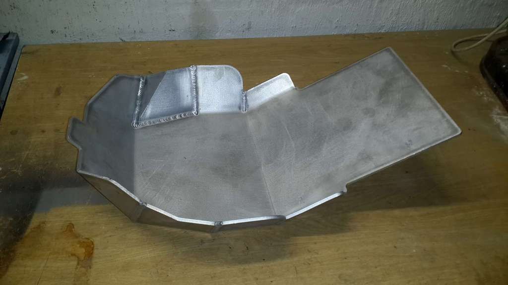

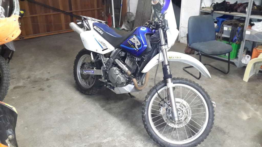

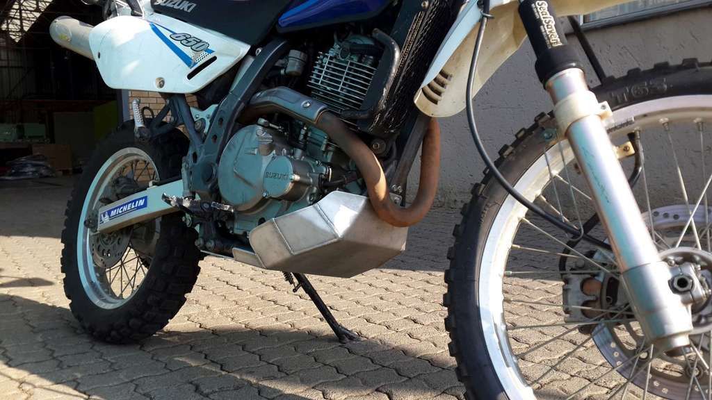

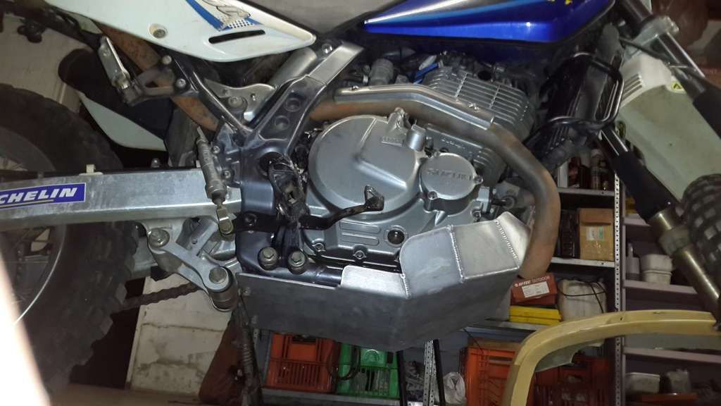

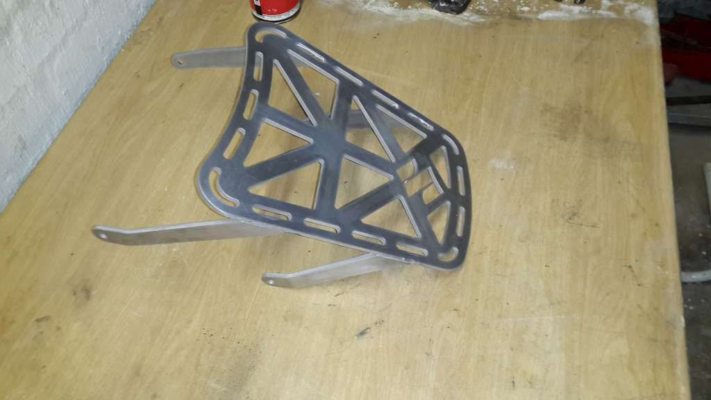

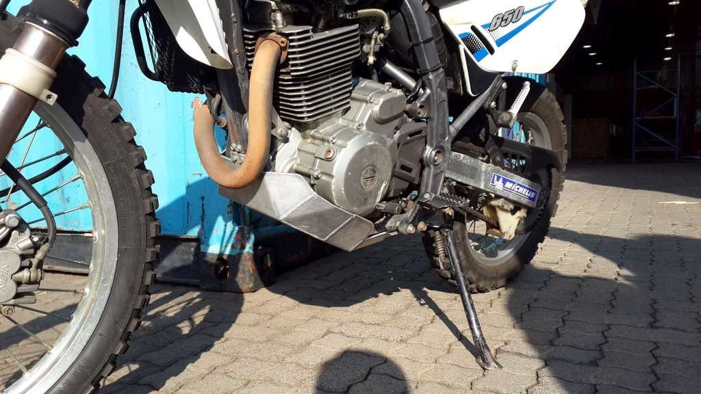

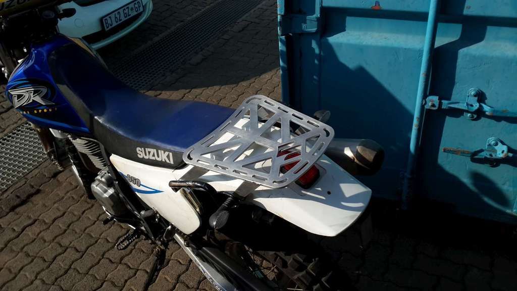

I recently designed a bashplate and rear luggage rack for my DR650 and had them fabricated from 5mm aluminium 5754. I am very pleased with the results. Here are a couple of photos.
Let me know if you'd like to buy one of these. if there is enough interest I'll get some more made up.
Here is the raw bashplate before drilling the mounting holes.
And the rack before mounting.
The bashplate on the bike.
And the rack on the bike.

Looking very good....  :thumleft: Just a idea... consider laser cutting some holes/slots in the bash plate for to get rid of the water and dirt that may lay in it.
Yup, still have to do this. I also want to cut a hole for the sump plug so I don't have to take it off to do an oil service.

That they do, but still one of the best luggage plates I have seen so far  :thumleft:

Need to cut laser holes especially under the sump plug.
