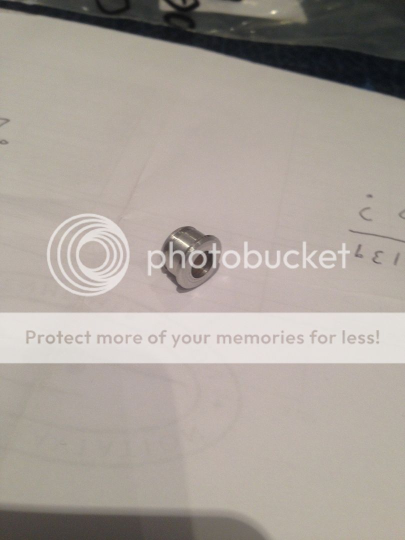

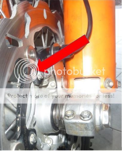

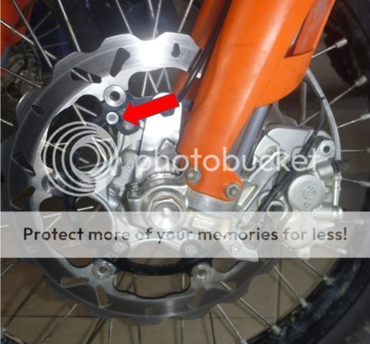

Therefore, this is the option I thinking of trying: drill a hole in the rotor to which the brake disc attaches and glue in an EXC speedo magnet (see https://advrider.cz/technika-lc4-rallye-en.php):
Can anyone maybe say if this is a really bad idea, or if it might work? What have other 690 rallye riders used, any help would be much appreciated!
