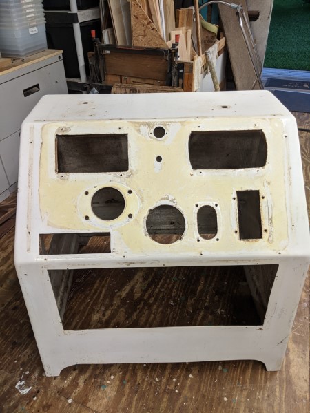

I'm going to try and take a leaf out of Gerrard's book of advice on projects, and try to do something every day. When possible.  :thumleft:

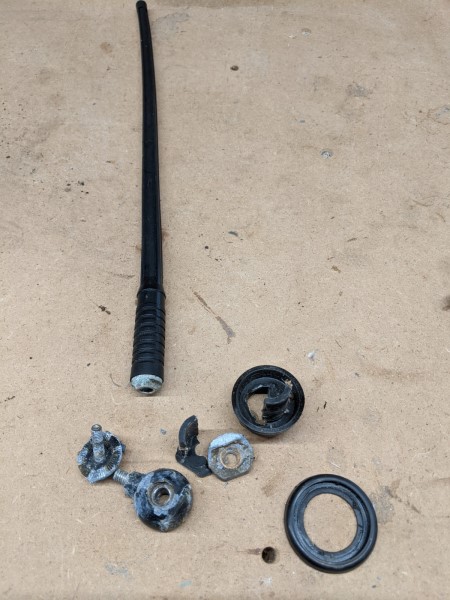

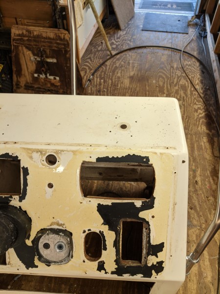

This evening after work I decided to finish stripping the center console.
The FM radio antenna was rusted fast, I ended up drilling out the screws that held it in place, and had to break it to get it out. So it went into the trash can  :biggrin:
Then I removed the steering wheel bracket and the ignition bracket, and the hand rail and shepherds crook.

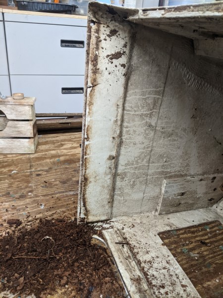

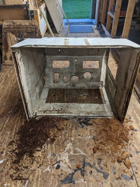

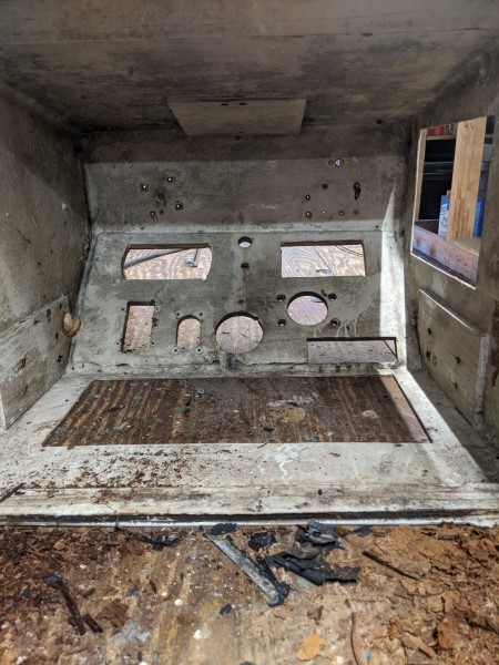

I turned the console over, and the two strips of plywood along the two sides that support the console to the floor of the boat were completely rotten out, I dug the remains out with a screwdriver  :eek7:
But I can fix that. The two strips are about 1/2 inch thick, and only about 4 inches wide. So I'll cut away the inner layer of fiberglass and clean it out propely, then put new marine ply in there, then cover with new fiberglass. The other wood inside the console seems to be ok, but I'll check it out properly.
The inside of the console now needs to get the bleach-water treatment, then some power washing. There are still some mud wasps nests inside there and other kak...
But the outside is starting to look good again. I'll probably fill in all the unwanted screw holes, then sand it down lightly and give it a coat of primer.

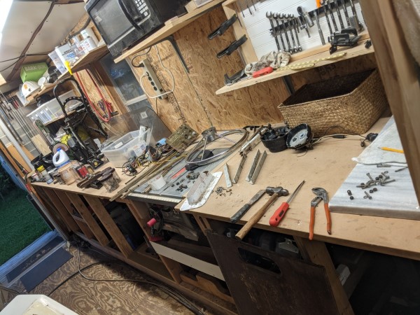

Already my workshop is starting to look like "n hoer se handsak" with all the stuff lying around. So I think my next job is to go buy a box of small zip-lock bags and start packing and marking all the small bits and pieces and screws etc before I forget where they all go, because it may be a year before I need them again.
Tomorrow is Friday!!! I start off my day early with a filter system install at a Mexican restaurant, then a full busy day again. But it's also payday, so I'm really hoping to be out of there by 5 or 6 pm.  :ricky:
