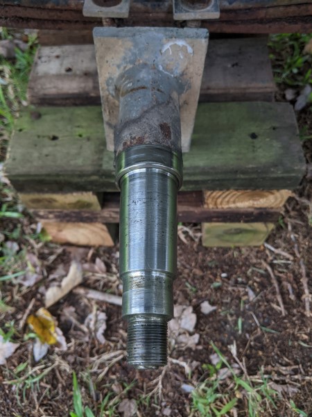

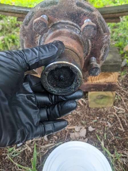

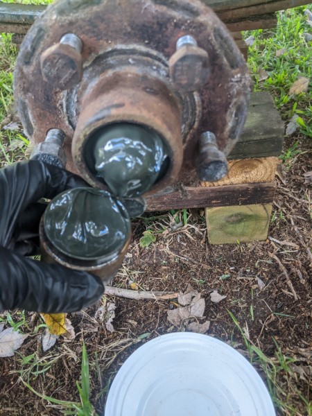

Eventually it was drier, and I got to work on the first wheel bearing. The wheel bearings on this trailer have something called a "bearing buddy". It is a cover over the axle nut that has a grease nipple in it. Before I towed the trailer home I added grease to these nipples until grease came out the back of the bearing seal.
Here you can see the bearing buddy with the nipple
And inside there is no water, just a whole lot of grease
Wiping the grease away and the steel surfaces are bright and shiny, no signs of any rust
And the axle is still in perfect condition!
I cleaned the bearings, and took the bearing buddy apart and cleaned that too, and everything is in perfect condition! The bearings are smooth and no signs of wear or pitting or anything. I coated everything liberally with WD40 after cleaning, to make sure that nothing will flash-rust before I can get it refitted and greased up. I completely forgot to get pics of the bearinsg and stuff, I'll try remember some time this week. But look at how even the wheel bolts cleaned up perfectly!

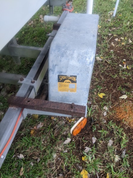

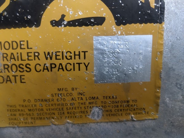

This trailer still has the original manufacturers sticker on the wheel cover. It is one of those metallic-type stickers, and I got some pics for y'all.
Lets get in even closer so you can see what it says  :sip:
The model is a "17 IR", so it was designed for a 17 ft boat, like mine.
The trailer weight is 600 lbs (273 kg's)
The gross capacity is 2200 lbs (1000kg's)
The date of manufacture is Jan 1977
So this was the original trailer that came with the boat, it's not often that you get that with an older boat like this in Florida. Usually a trailer that old has returned back to mother earth as rust  :imaposer:  But this trailer was put together, welded, and then hot-dip galvanized. It is incredible, not a single spot of rust anywhere. And it even has a fancy lever on the side that lifts up the keel rollers to make launching and recovering easier! I'll get some pics of that too later on...  :thumleft:
