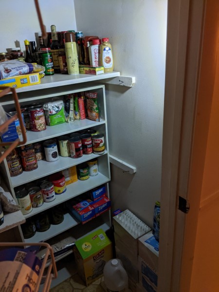

« Reply #10764 on: January 10, 2021, 01:34:32 am »
So today was interesting...
I left home early, had to go to the bank to pay some bills, then I went past the Discount boat shop and bagged a can of epoxy resin and hardener. On the way home I went past work and grabbed the dirty towels out of my work van that I had forgotten to take out yesterday.
At home Mrs Zog asked me really nicely, while I was eating the sandwich she had made me for breakfast, to make some additional shelves for the pantry cupboard.
So this is what the inside of our pantry cupboard looks like... lets call it the "before" pics.
The small shelves you can see in the back are just old shelves that were in the workshop when we moved in (I think?). They were pressed into service in the pantry. "Just until I get around to making new shelves"...  :peepwall:
Well that has been 2.5 years now, and it's time I guess....
So the plan is to remove the free-standing little shelves, and the lower built-in shelf.
Then I will install new shelves against the back wall, as well as bringing them forward along both side walls to increase shelf-space. If you look closely you will see there is a access panel against the left wall, as well as another one low down. These need to remain accessible so I can get to plumbing pipes behind the shower.
Anyways, I went to the Home Depot after taking some measurements and designing a plan, and I bought a single sheet of 3/4" (19mm) plywood. I got them to make just two cuts so that I could handle it a little easier. The rest of the cuts I will make myself. I also got a can of white paint to paint everything when I am done.

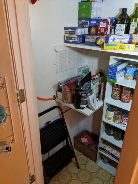

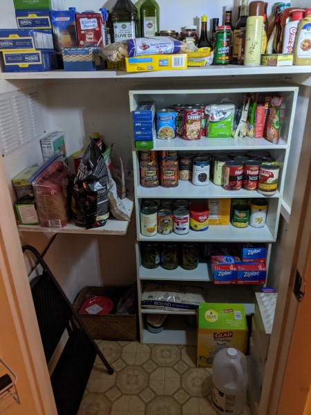

« Reply #10767 on: January 11, 2021, 01:28:51 am »
Spoiler alert - I didn't get the pantry shelves finished.
But I did a whole lot done.
So this morning Mrs Zog pulled out all the food from the pantry and packed it away in the study where the dogs will hopefully not be able to raid it  :lol8:
Then I removed the old shelves and brackets and the two little bookcases from the pantry.
This is where I found the first snag. The holes in the wall.
I kinda knew they were there, but I had only had a cursory glance at them behind their covers when we bought the house. Now I took a good look and did a bit of deductioning  :peepwall:
I am surmising that the top hole was where the mixing unit for the shower (it's right behind that wall) used to be, and the lower hole is where they cut away to get to the pipes that come up from the floor when they rebuilt the shower some years ago. The old copper pipes show signs that they did leak a bit a long time ago, but they are fine now, the repairs are good, and I'm not going to mess with them.
I decided that the top hole can be permanently closed, but the bottom hole can stay open, but with a cover that I will screw over it, so that in the event of a leak I can have easy access for a repair. But I don't need such a big hole, so I decided to make the hole a little smaller.
The first thing I did with the repair was to cut the hole square, and just a little bigger so the left edge was over the stud running up the wall.
Then I added a little strip of offcut plywood inside the wall at the right hand edge, screwing it in place with a couple of drywall screws.
I did a similar job on the bottom hole, but a added some plywood strips at the top and bottom of the hole as well.
Then I cut some sheetrock (drywall) to the correct size and fitted it in the hole, screwing it in with drywall screws.
It's important to screw the screws in so that the head of the screw is just below the surface of the sheetrock.
And I did the same with the bottom hole...
Then I spread a layer of "mud" (that's what they call this very fine "polyfilla" here) over the patches and let it dry. The top hole needed a bit of a thicker layer to get it all perfectly smooth, and this took several hours to dry, even with a fan blowing directly onto it.
