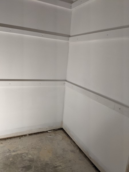

Progress update  :sip:
This morning I made an early start, after my second coffee  :spitcoffee:

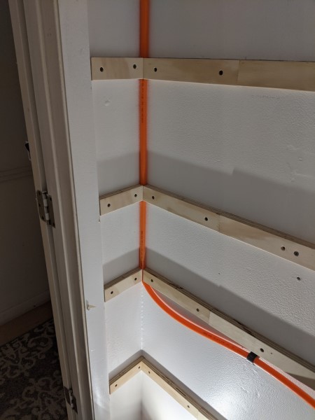

I cut the strips of plywood that support the shelves to the correct length and screwed them to the walls. Each wall had to have it's strip cut separately as the walls are horribly out-of-square.
In the one corner I had to make allowance for the water pipe (water from the Reverse Osmosis water filter to the fridge) to be secured and placed out of the way.
Then I gave all of the strips a coat of paint. This was just to help to start sealing the wood, these shelves are for the pantry and it is plausible that some or other liquid may spill there some day, and I'd like the shelves to outlast such events  :biggrin:

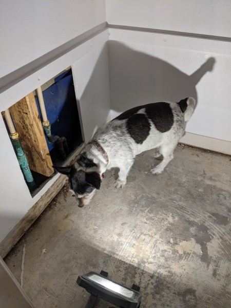

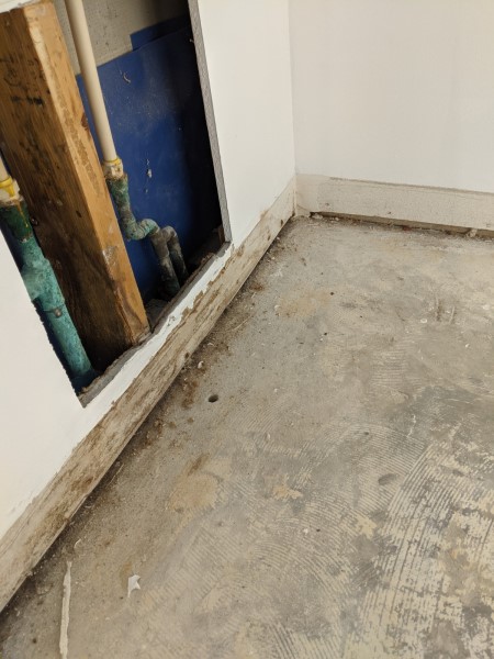

I also removed the baseboards at the bottom of the walls as I will be completing the wood-vinyl flooring from the passage into the pantry as well.
Of course my "inspector" came around to make sure that my work was up to scratch...

I notice that handymen in US use a lot of plywood cut into strips and bits.
Is that out of preference or is ply just a generally inexpensive timber source compared to ordinary timber? (like our SA Pine)
  • Posts: 8,284
  • Thanked: 506 times
« Reply #10810 on: January 18, 2021, 01:43:29 am »
Ply is generally cheap and easy. If you cut it into thin strips it doesn't split as easily as solid pine, and it keeps its line and flat better too. No warping and twisting.  :thumleft:

Here are the completed pics. Well ALMOST... I still need to cut a piece of hardboard to size so I can cover the access hatch to the plumbing. But this will be a simple jobbie for another day  :deal:  :imaposer:
