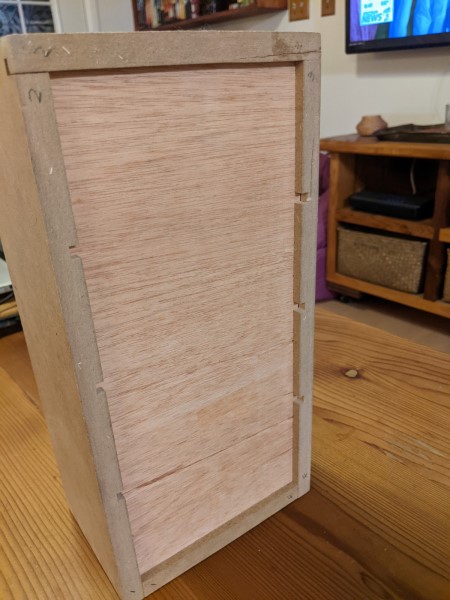

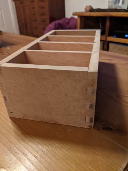

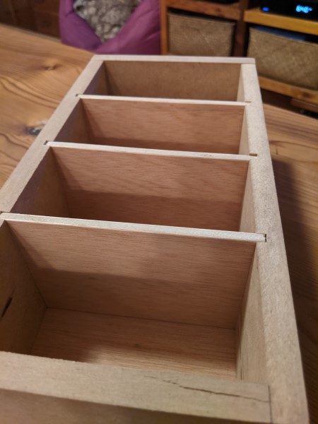

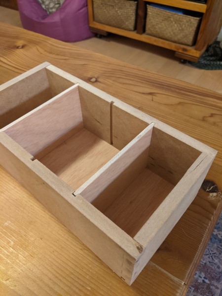

Just a small box. It's 30 cm deep, 10cm high, and 15 cm wide. Outside dimensions.
This took me the rest of the day.  :sip:

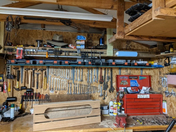

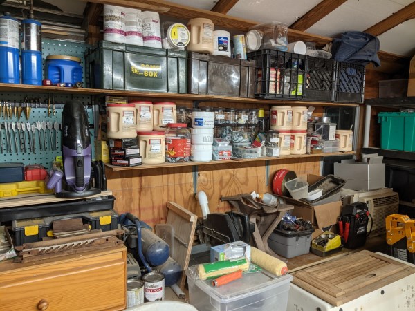

But. I have a reason. You see, I want to make 100 of these boxes. I want to make a storage solution for my workshop for all my hardware; nuts, bolts, washers, wood screws, stainless steel screws, and a shit-ton of other bits & bobs that I have stored in various places around the workshop...
It's always a mission to find stuff, and with the way stuff is now, I usually end up having to unpack half the shelf to get the little jar or bottle or whatever from the back.
So the idea is to build a shelf with 10 drawers high, and 10 drawers wide, 100 drawers. And each drawer has the option to be divided into 4 sections...
Like this.

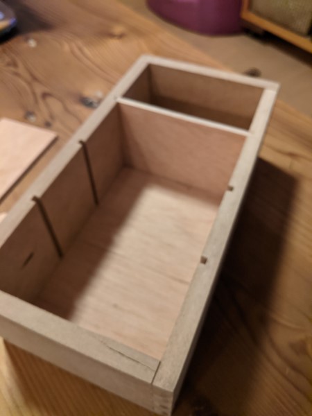

Each corner will have a couple of box-joints, or finger joints.

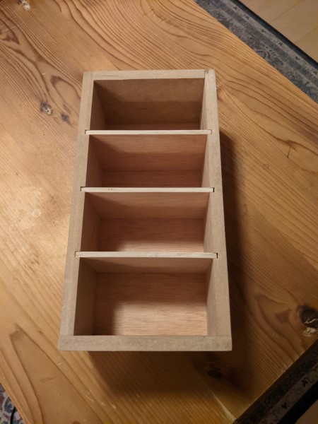

And the dividers are just in slots so they can be added or removed as needed.
The bottom sits in a groove 1/4 inch from the bottom all the way around.
So no screws or nails required in assembly. Just some wood glue.
My biggest headache during the build of this simple box was figuring out how I was going to make the other 99 in such a way that it resembled an assembly line... And not doing any of the steps out of sequence in order to make my life easy. I also built a couple of jigs to make things happen much faster with the minimum off fuss and bother.
So now I just need to figure out how much wood I'll need, then get to it.
Oh, and also deciding how I'll be opening the drawers. I'm thinking just a simple "U" shape cut into the top of the side that my finger can grab, and that will not let any of the contents fall out.
The drawers will be a close tolerance fit into the frame they will sit in, so no sliders or whatever required, and I can remove a drawer quickly and easily if I want to take the contents back to the workbench or whatever.  :thumleft:
Comments, suggestions, hints, tips, appreciated  :thumleft:
Looks great. My only concern is how much space the planks will take up.
I see this bloke had the same idea roughly.
I managed to get quite a few of those metal framed ones with two sizes of plastic drawers some years back and works well.
I also scrounged some of those plastic drawers which one sees in the spares shops. I think if you got hold of some of those and made a wooden frame it would take up less space and save you time.
That said, I like seeing your projects and ideas.  :thumleft:

The easiest way to open the drawer is a single hole about 1" diameter on the centre line about 3/4 way up the front
I built drawers for my clothes cupboards using ply and shutterboard.
I drilled two holes 1/4 distance in from each end.
Alternatively, just cut the front panel 20mm lower than the sides.
Then you can also look into the drawer far more easily.  :)
For assembly line process, cut / have your side panels cut in strips to the height you need.
I would use board for the base, front and rear, cut to width and I'd use ply for the sides.
With the timber in manageable strips, set up a guide and stop for the side panels.
Cross cut to length, then raise the saw to cut the grooves for the divisions - first and last the same distance from the end.
Adjust the stop and cut the middle groove.
Cut the base, back and front to size.
Assemble base,front and back upside down, glue and nail.
Fit the two sides, glue and nail into the side of the front, base+ back.
The nails act as shear structural members.
If you want it to look less utilitarian and more "professional", glue a thin face piece onto each drawer to cover the joints and/or gaps.
If you use strips of a nice veneered 1/4" ply, match the grain grain pattern across each row of boxes or down each column of boxes.
That way you will see if drawer is out of position.
I saw that brilliantly done in a shelf of lever-arch files.
The occupant glued an art poster onto all the files, then trimmed them and covered each with clear vinyl.
When placed back on the shelf, they formed a lovely artwork instead of a boring old bunch of files.
If you want smooth running drawers, use polypropylene strips fixed to the framing as runners.

Great points R, thanks.
For the finger grip I will probably just go with a small (about a 3/4 inch) half-round at the top of each drawer, less chance that the contents may spill out.
I don't want to use any nails or screws or any other form of metal fasteners. Just wood glue. And I'm actually going for the utilitarian look, I want to see the joints on each box  :biggrin:
I'll probably stick a label to each face describing the contents. And I'll also wax the bottoms of the drawers and the tops of the inside of the frame to facilitate easier sliding. No budget for sliders or stuff  :lol8:

When I did the final work-out of the wood I'd need to get the job done I found that to do 100 boxes would mean that I'd need an extra sheet of MDF (Superwood) with a whole lot left over. So I cut the numbers down to 90 boxes, this meant  that I could get it all done with just 3 sheets of MDF and 2 sheets of 1/4 inch ply. The cost thereof at Home depot means that each box will work out less than a dollar. The plastic bins are between 3 and 4 dollars each, depending where you get them, and they are nowhere near as nice as the wooden ones.
So this morning I went off to the Home Depot and bought the sheets I needed, and back home I sliced them all up into the strips I needed.
I also video called my mom on Whatsapp and showed her the SpaceX Falcon 9 launch LIVE from my back yard this morning  :biggrin:  She loved that!
Then it was setting up a jig on the table saw to cut the MDF to the 2 different lengths I needed; 12 inches for the sides, and 5 - 7/8ths for the fronts and backs. That was easy enough...
Then I set up another jig on the table saw to cut the groove for the bottoms on all the sides.
Finally I set up a jig to cut the grooves for the dividers in the sides.

So a slight change of plan...  :peepwall:
This was a very laborious and repetitive task... and it made a LOT of dust...  :eek7:
The sides with all their grooves... all 180 of them  :eek7:
And the fronts and backs...
The dust from cutting the MDF was everywhere  :sip:
Anyways, after making all those cuts it was pretty dark outside so I called it a day and cleaned up. I'll cut the edges of all the sides for their box-joints next time. I really need to come up with a decent dust-capturing solution for my table saw.  :dousing:
And yesterday I forgot to take a pic of the reclaimed wood I scored. The wood crates were from a couple of submersible well pumps that we uncrated at work for a big job coming up. Hence why they looked like planters... long and thin, so they can fit down a 6 inch well pipe  :thumleft:

Gary,
Looking at those box sides, something just looks wrong with the dimensions, just asking.  :sip:
An aspiring Coddiwompler
Offline Blou Zebu
  • Posts: 1,154
  • Thanked: 199 times
« Reply #10858 on: January 26, 2021, 08:42:02 am »
Gary,
It's because they are in inches and not centimeters!  :imaposer:
