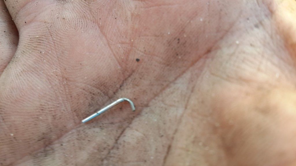

Why and how many?
First at Piet Plessis because of this staple.  I am still not sure it it was part of the tyre.  It created a whole that the slime could not seal.
Second at Welkom when the slime made the patch come loose. Replaced slime filled 17 tube with a 21 inch front tube at Farmer Strauss's house.
Third one (not forced) replace the 21 with a 17 inch Jean le Roux gave me.  Then when the tyre  on the bike, I I realized that the tyre, that we cleaned from the slime inside it, was placed on the wrong rotation.  So off come everything. Do everything over again.  This 17 lasted 5 km before it blew.  I think we might have pinched the tube when fitting it.
Fourth time replace the blown donated 17 with the old 21.  But I saw it not fitting properly this time.  Took it off and re-fitted it again.  It lasted 20km to 5km from Askham.  It also blew, most likely shoddy workmanship by the fitter :)
5th time.  Replace blown 21 with old slime 17 from the first day.  As Askham.  it lasted 1200km and is still in action.
What I have learnt.  Try to have endurance heavy duty tubes.  I did 25000km previously without any hassle.  Last ime the value tore from the tube, but that was after all those k's.  Make sure you have a set of tyre levers.  make sure you have a patch and solution kit.   Carry a spare set of tubes.  or convert your tube to tubless.  I understand it can be done.   Slime worked before but his time it was trouble
