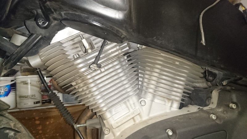

Rear cylinder. Just getting the plug in requires very small hands.
To give you an idea, the head sits behind the frame where the yellow circle is.

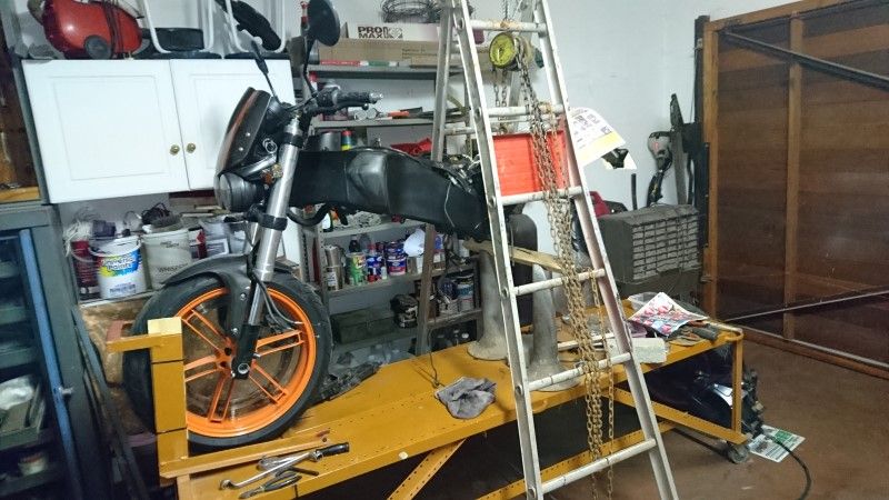

Bike on bench ready for work.
The offending hole, highlighting access issue.

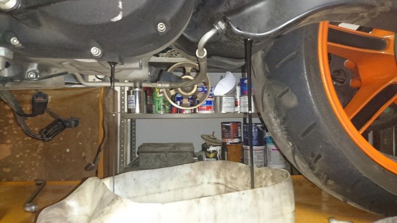

Draining the oil. Main engine and gearbox is dry sump, with oil stored in the swingarm. Primary oil is in the primary cover.

Here you can see the front vs rear cylinder access
