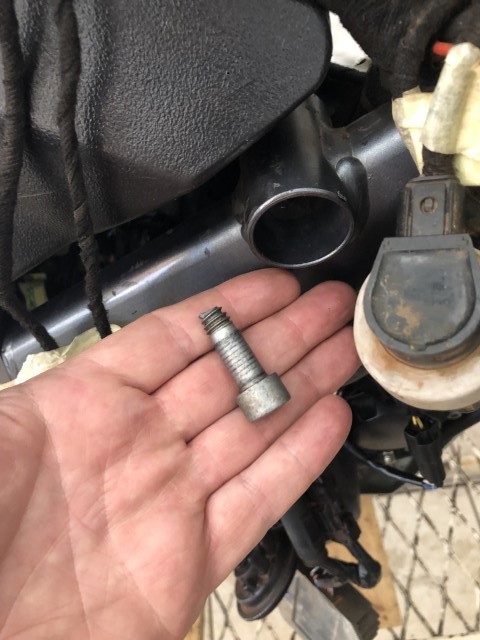

So, roll on Easter Weekend, Friday involves a quick trip to @Halfdaft to grab some of this fine oil, he sold me a bottle as I could not find any on the East Rand (Well, not at less than R750 for 4-litres)

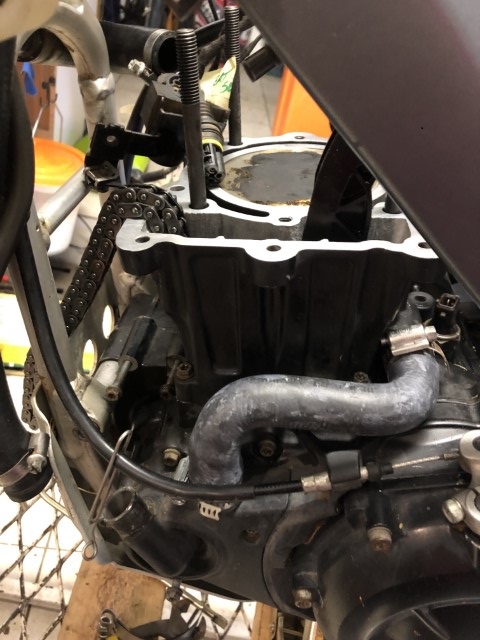

and back home - barrel on with a new base gasket, sikkled a bit, took it slow & steady, added a new hose as well, precautionary, you understand, as the other had a scorch mark on ....
Add the skimmed head, torque it doen in the correct order, put in the bolts that hold the head onto the top frame, tork them to 74Nm and.......
FFS!!!! the donerse M10 bolt has sheared off in the head......  :-\ Fork. Step away from the tools, slowly mind, get a chair and stop myself from throwing up..... Is this bike going to fight me the WHOLE WAY?????
WhatsApp Halfdaft, we discuss the options which are:-
a) Just leave it and carry on regardless...... Downside here is that the Rear shock mount locates on the back of the head, so if it flexes, it could potentially crack parts of the head....
b) Take the head off and try and get it out of the top of the frame - The chances of success are slim, as the sheared bolt is sticking out into the frame, so I cant slide it up & out - the upside is that there is some sheared bolt and there MIGHT be enough to grip with a vice-grip to get it out. Downside is that I will have to replace ANOTHER R600 head gasket.....  :'(
c) - Take the entire engine out and work on it on its side. Downside is that its still going to be difficult getting the head section out of the frame, and to take the motor out you have to remove the rear swingarm - moerse pain in the arse..... Upside is that a new head-gasket is not required......
What to do.........
After discussion, option b) is going to be the most viable......
But as Saturday was already dedicated to home-affairs, and I had a somewhat epic hangover, I only approached the Blitsie after lunch.......
