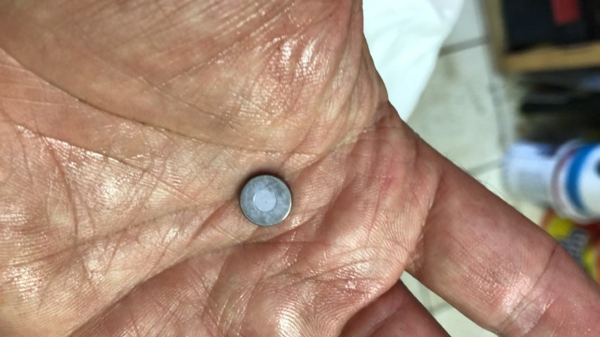

So then I decided that I might have mis-timed the cams, maybe out by one tooth on the exhaust, or inlet perhaps? Ony one way to find out, whip the panels off, airbox off, injectors etc., and off with the valve covers.
First - check the cam-sprocket alignment at TDC - spot on, so thats not the problem....
Second, check the valce gaps.
Inlet - under 0.05mm, so spot on.
Outlet - one is 0.25mm, perfect. Other one is 0.95mm........ Now thats a problem.....  :o - WTF happened?
Remove the cams then, take the bucket of the one exhaust valve top and were the hell is the shim????? Vanished!! How does a shim vanish off the top of the valve spring cover, in a bucket, so a sealed area???? Thought process kicks in - go look in the discarded plastic bags, all neatly labeled, and....
How, in the name of all things motorcycle related, did that get left out??????
Long and short, replaced it - bucket was not damaged luckily - replaced all the bits - tap the starter button and she fires up first swing.....
So - more testing Wednesday!!

Ummm and you didn’t notice when you checked the valve clearances after fitting the cams?  :sip: just asking  :biggrin:
And I wondered if the question was going to be asked....  :imaposer:
I did measure, but before i took the cams off - theory being that there is no adjustment anyway, so if its measured before removal (manual recommends this) and then I reassembled them. I didn't check again after assembly - I mean why bother......  :eek7: and that's where the lesson was learned.....
I am very glad the bucket wasn't damaged!!!
But in all honesty, I should have worked out something was amiss when i tried to start it, it battled a bit, back-fired twice, and sounded like there was a tappet knock (which there was) - the only downside was a slight performance loss (one exhaust valve is opening late & closing early) and it just felt "off"
At that point i should have re-checked, but I was impatient......
