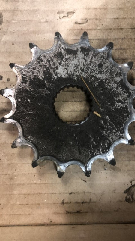

I had the oil leak from the final drive/countershaft area, so yesterday I stripped off the cover and removed the drive sprocket, the back looks like this....
So the indication is there that oil is spraying up from the shaft, so we know where the oil is coming from...

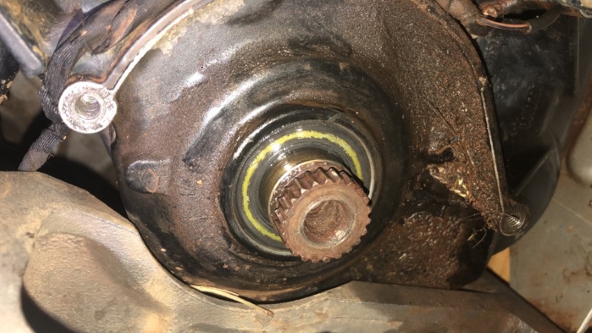

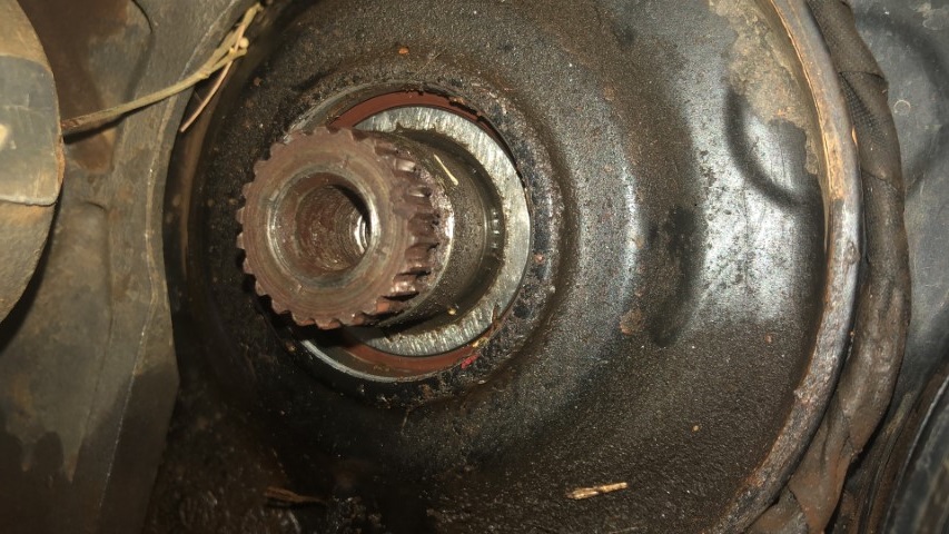

Upon investigation we see this....
The mechanically able will recognise that the silver ring is the seal on the internal bearing and between us and that, there should be a seal.....
So you can deduct why the Doff is mentioned....

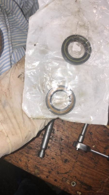

Searched my parts bins and discovered....
And then had to face my own stupidity, not once, not twice, but thrice!
I obviously fitted the bearings in the engine case, with the view that I would install the seal when the engine was assembled and I could turn it over, 2nd in-attentive moment would have been when I installed the drive sprocket, surely I should have seen the lack of seal then? And thirdly, when I was cleaning up and saw a sealed packet of seals (I ordered 2), I should have asked the question, but no.....
Anyway, after berating myself with beer, I fitted the seal and re-assembled...

:imaposer: Yes, I guess one should confirm that it is IN PLACE before considering REPLACING it.
I'm so glad that it was a simple fix and that you caught it in time!
[/quote]
You see now.
My defense is that it's out of view behind the sprocket.
 :imaposer:
