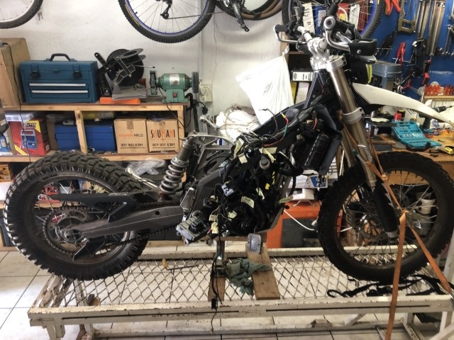

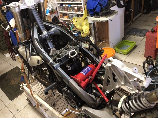

After a moments reflection, because this is somewhat akin to a pilgrimage, I started looking at what needed to be done to remove the head, broken bolt in-situ, and realized that I could potentially spread the 2 arms of the frame to get the head out, I only need 5mm, maybe less....
Best way to do that is to loosen off all the lower frame arms and rear swingarm mounts to allow some "play" in the system, so first step is to remove the rear subframe, so that I can access the rear shock top mount, unbolt the top and swing the support bracket out of the way.... THEN remove all the torqued head bolts and get it ready for removal....
That took a while as I wanted to make sure I was getting the correct bits out in order... And then i grabbed a bottle jack, made up a quick support jig, and started pomping, and.....Nothing..... Mainly because I forgot to close the bleed screw on the jack...  :biggrin: Anyway, closed screw, slowly jacked the frame arms apart.....
And SUCCESS!! there was just enough room  to slide the head out, complete with broken bolt!

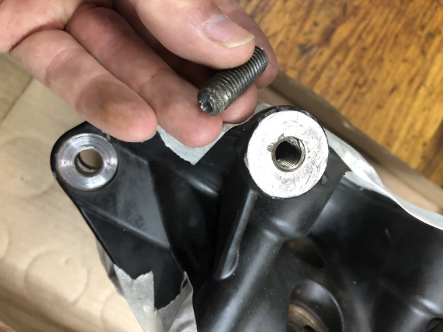

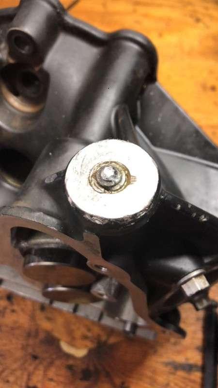

As you can see, there isnt enough to grab onto, but what I did manage to do, was drill a small flat onto the end, whilst it was still in the frame, using the adjuster as a guide - this would go some way in helping us out later....
Sunday morning I was off to @Halfdaft on the 1200, head tucked away safely in the top-box.....

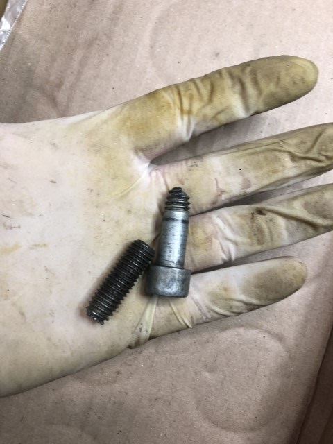

After I got there, and inspection was completed, he whipped out the Bosch cordless drill and what I remember as a small Left-Hand drill bit, and proceeds to try and drill the broken stud, to get a hole to use an Eezi-Out - and while he is drilling, the bot actually starts un-turning itself!!! Well, a little bit anyway, so Eez-Out on, and bolt out, dress the helicoil, i load up and off home again - I am seriously pleased with my day so far!!
The offending broken cap-screw....
At this point i decided to use the head-gasket i had just put in, based on the fact that the bike hadnt even run with it in yet, and BMW is closed for another 2 days.....

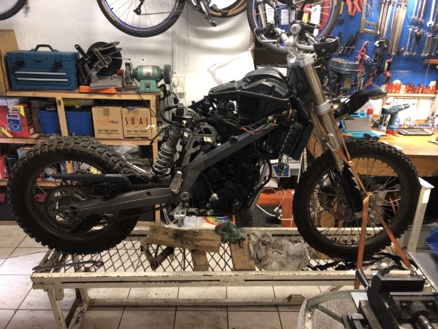

I continued with the slow & methodical assembly, head, valve tappets, cover, rear spring & mount, airbox...
And then the rear sub-frame, including the fuel tank, rear fender etc..... And as I bolt in the long M8 mounting bolt (I replaced the 2 short ones, right at the beginning...) and the bolt strips....... I DESPAIR, I feel I may be cursed,or Blitsie is, or both..... BUT, I know I can get one on Tuesday at any rate......
Funny thing is, the Steel thread was screwed into Alu, and the thread in the Alu is not damaged, but the threaded steel capscrew.....  :eek7:
All was not lost though - after connecting everything back up, battery in, coolant & oil filled (And Spilled) he fired up after a couple of cranks, into a smooth idle.....
After running it up to temp, the fan kicked in & off again as required, so we know that is all working....
No signs of coolant or oil leaks, but then there wasnt last time either..... But in the absence of the rear sub-frame bolts, I will not attempt a ride for a day or 2!!

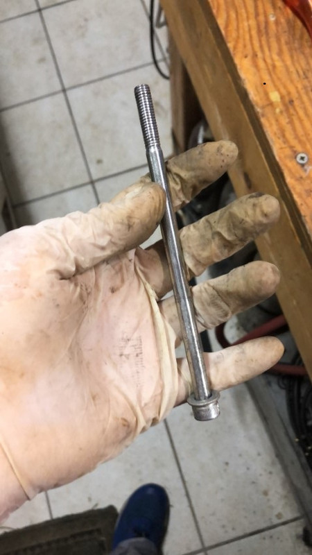

@ClimbingTurtle Did you reuse old head bolts? Never really good idea to reuse head bolts as they stretch once installed. This is probably why the bolt sheared off perhaps? But my hats off to you ,you've got the patience of a monk. I would have long time ago already lit the bike on fire!
No - re-used the bolts - the BMW manual doesnt specify that they need to be replaced (actually nuts, not bolts, the head bolts are studs), so I re-used them - they do make mention of what ones not to re-use, but this wasnt one of them.
This is actually a bolt that mounts the head to the frame, so not the head to the barrel.....
And I am too far in not to be patient - and I'm off to fetch the new cap-screw i need!!

@ClimbingTurtle Generally rule of thumb you want to replace nuts and bolts/studs that get loaded quite often this includes the suspension bolts from time to time stretch and snap and engine mount bolts etc. It's just a rule of thumb I use that saves me from having trouble in the future like you are experiencing now hehe. But luckily you got it out. Snapped bolts are a b****. Hopefully you can get the bike running in proper order soon.
