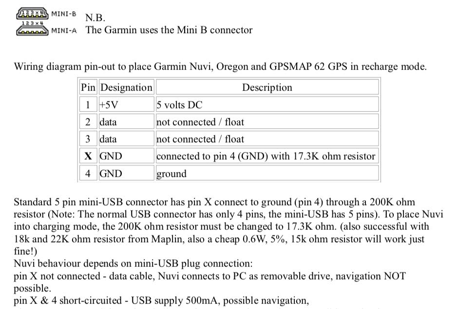

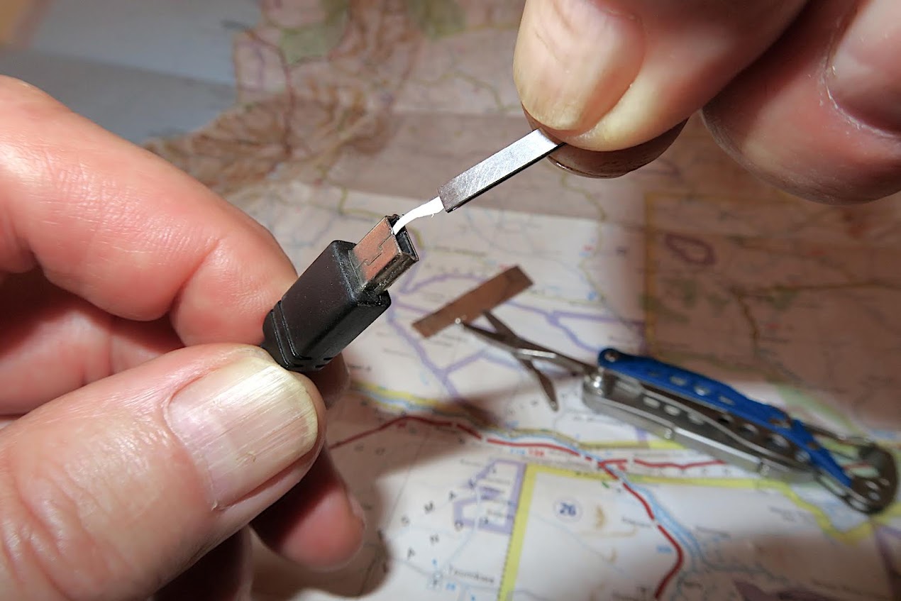

Nothing has come loose or fallen off the bikes, but mrs Owl’s GPS stopped working near Modimolle (Nylstroom) when the Zumo’s battery ran out and the USB cable I bought there made no difference. On her bike I installed the standard Garmin power cable with filter and inline fuse, so presumably that’s where the problem lies. A quick check with the continuity indicator confirms this diagnosis. Unfortunately I did not pack any 1A fuses, so a 10A one will have to do.
My GPS now exhibits the same problem as the Zumo on mrs Owl’s bike. As soon as I turn the bike’s USB power socket on, the display says “SAVING TRACKS…” and at 4% it dies. I did not pick this up before we left, because I had cleared the tracks before the trip (so there was nothing to save). Clearly, it’s a cable problem and the GPS is trying to write data to a non-existent recipient on the bike. Fortunately, there’s WiFi and an hour or so later it’s clear what the problem is and how the GPS can be “told” that there is no computer to write all that data to.
While the regular USB connector has four contacts (+5V, Return and Data +/-), the mini USB has five contacts and the extra one is used to distinguish between regular charging connections and data comms. The likelihood of sourcing a 17.3 KΩ resistor out here in the gramadoelas is zero and likewise the probability of finding any soldering tools required to make the required link. But…we have some aluminium tape and after trimming a thin sliver of this and carefully prising it into the USB mini connector with a tweezer, I eventually manage to push the connector onto the GPS with the tape still in place and the GPS is happy at last.
