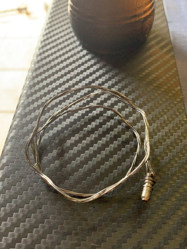

3. The tube fishing thing is good. I use a home made one with an old valve inner, and some very thin wire fed through same. Saves a lot of headache.

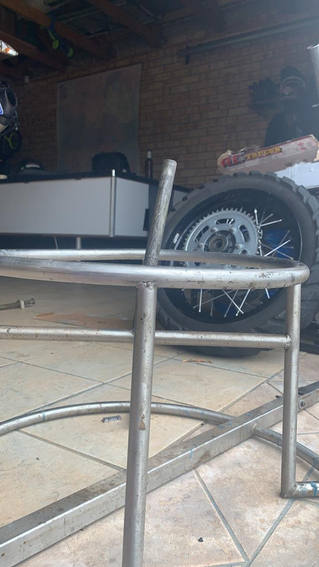

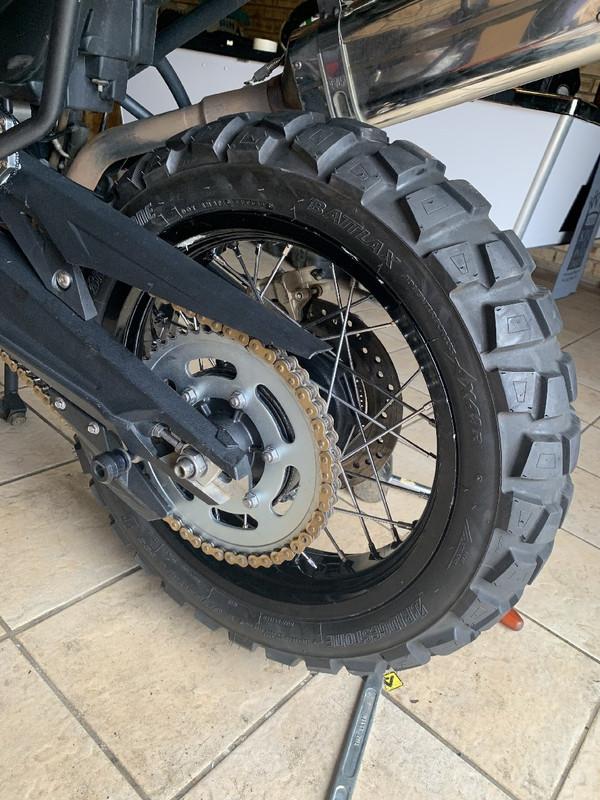

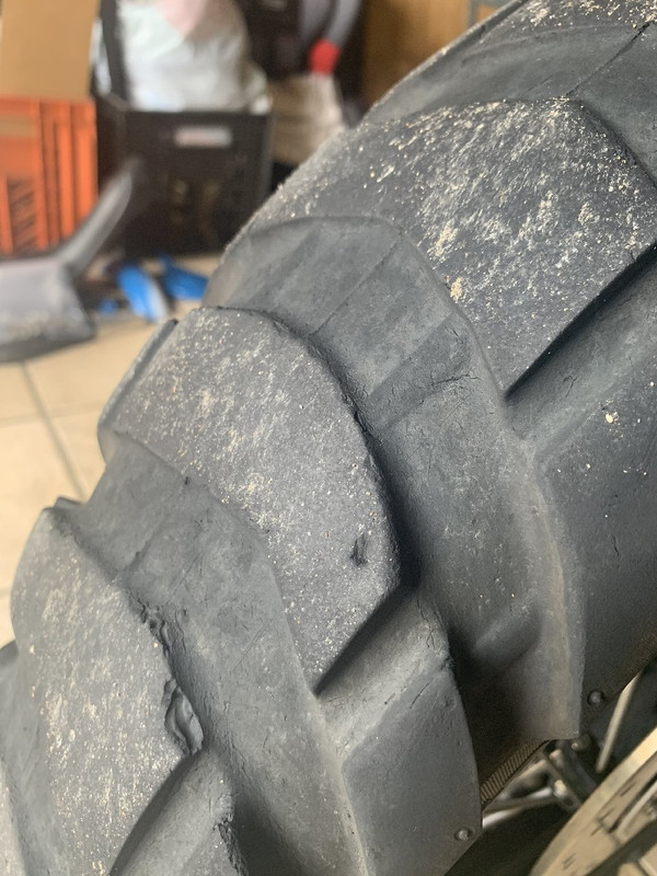

So I did it, not on the trail or anything stupid like that. Rather in the comfort of the garage with a plethora of tools a nice chair, company, assistance (from the wife) and beer. Let me tell you now if you have never done this before it is quite fkn unpleasant. This is a job for a shop with a tyre machine! I am however glad I done it and know that it can be done so that if I ever have to do it on the road it is less of a worry.
This is the tyre that needs to come off.
First step is always to give the bike a good clean, it wasn't dirty or anything but we're under lock down and I'm bored.

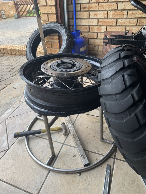

Then proceeded to bend the MF'ing tyre stand trying to break the bead. I had the missus standing on one side of the tyre while I was trying with all my might to break the bead. NADA. Niks. Hy wil nie. Went and had a beer and re-thought the strategy.
It's rarely brawn that wins these type of fights, this I have learned trying to fit mousses to Enduro bikes and to Rallye bikes with Rallye Mousses which were all made in the pits of hell, after remembering this I went back and sprayed a bit of lube and beat the bead off the tyre with a 4lb hammer.
That fight was won, now we're getting somewhere.

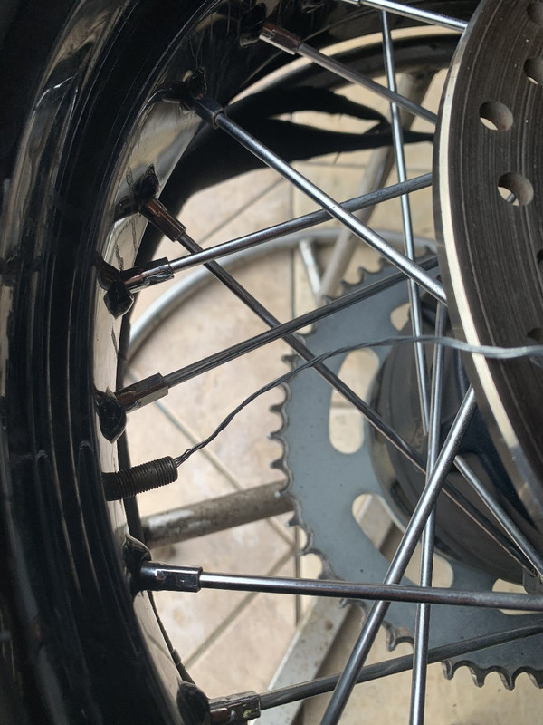

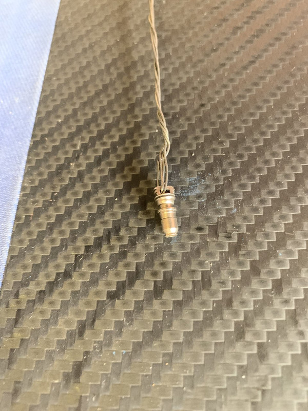

Someone posted a link to a valve pulling tool which obviosly I didn't have so I made one. WHAT A LIFESAVER! It's now in the bikes toolkit. Whoever posted that I owe you a beer. Thank you.

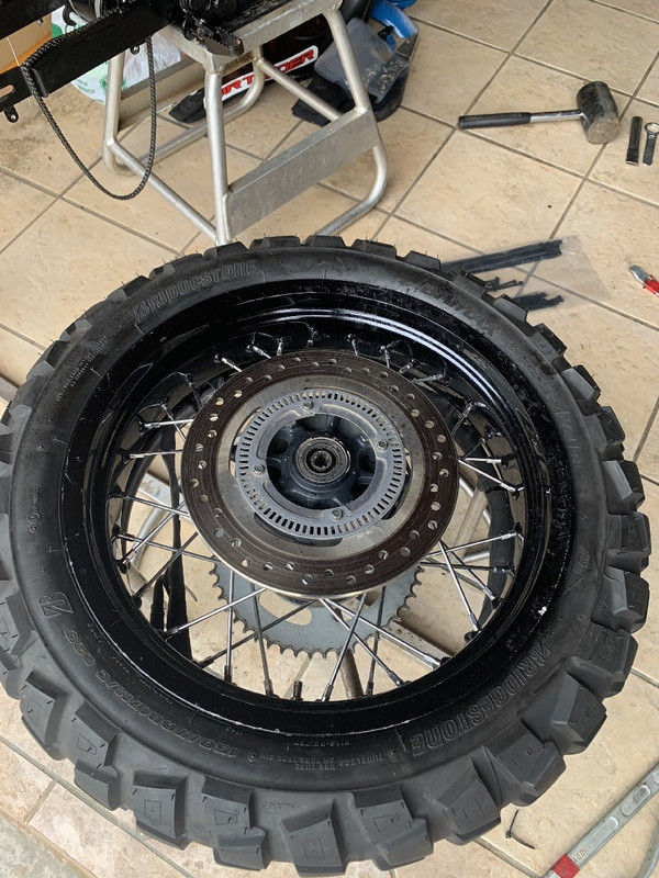

It was mostly plain sailing after the old tyre came off. When I say plain sailing the neighbors have reported me to childline, the domestic abuse number and the SPCA.
New Tyre on, looking good.
Thanks for all the advice I hope I never ever have to do that ever again, anywhere.
