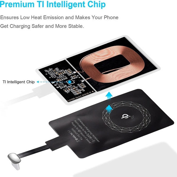

I decided to change the GPS and phone wiring -in essence, I want less wires but also redundancy.
Ordered RAM's wireless charger. They have the X-clamp version too but I've been getting quite annoyed by the way my current X-clamp would press the buttons on the side of my phone. So decided to try another option. Will see how it handles the phone in landscape mode..
Its a bit heavy though.. specs state 300g but maybe that includes all wires and such. The carbon part of my tower only weighs 300g, so that puts things into perspective  :o
So although its much handier, it does weight substantially more than my current old-school X-mount.
But anyway, going this route means I wont need dedicated USB-A and C wires anymore.
Both phones will require something like this:
