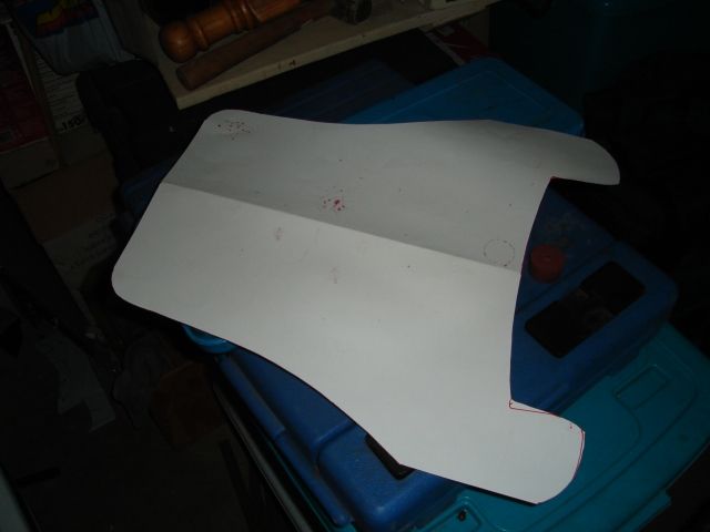

1. Borrowed a screen from a mate, traced the outline (See picture), Modified a bit to get rid of the "lip" just above the head light.

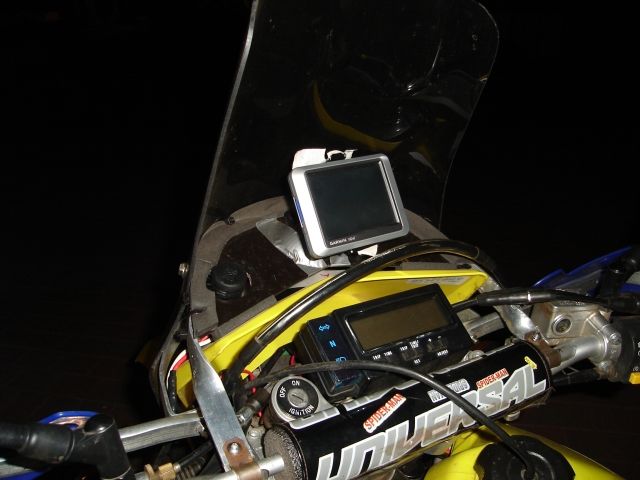

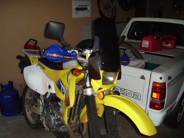

4. Bought some aluminum bar a Builders Warehouse that I then shaped to form the brackets of the screen.(picture)
5. Mounted the top bracket on the Handle bar and the bottom one on the hand guards. (See picture)
6. I also created a little dashboard, where I mounted the 12V socket to the upper bar. I also use this dashboard for my GPS's suction mount (Add a bit of Duck tape to make sure it stays there)

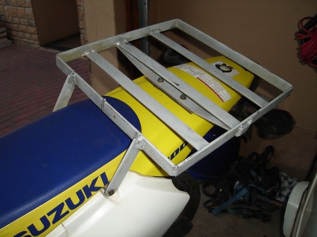

PS: I also built a a carrier rack for my luggage (see picture)
