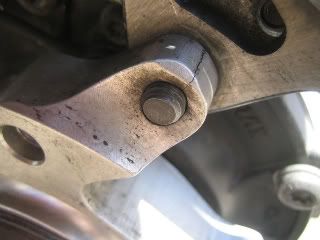

* Remove rear wheel and check flange for cracks, problem most 04 and 05 models. expensive repair.

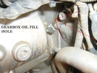

Check where the gearbox and engine casing join for a thin line of oil on the outside, it is a sign the gearbox input shaft seal might be leaking, meaning oil is getting through the engine onto the clutch.  bike to be split to be repaired, expensive fix

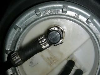

*On the throttle side remove the panel and check for small hairline cracks on the fuel feedback flange, connector. Expensive replacement part.

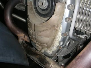

*The first day you have the bike home loosen the FD and check the pinion shaft for play, and check if the shaft is lubed. relatively expensive repair.
was at the local bmw dealer at the start of the month and they had one of those lying on the counter - i recognized it from your photos - and each and every one was also cracked
Please can you give some more info, what is the FD and where is that photo taken from, the back,front left right? I can see a disk on the left but have know idea where this is on the bike?
thanks
B
[/quote]
ai ai jai jai jai :o   :imaposer:
his is when you drop the wheel out, loosen the stabilising arm on the final drive and then the final drive drops down!!!!
Thsn you will see this picture :mwink: :mwink: :mwink: :thumleft:,
