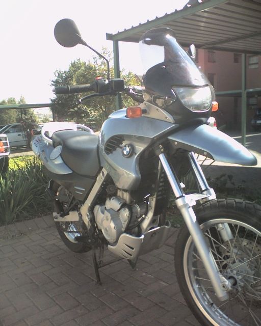

So this is what my bike looked like 5 years ago before I started inflicting punishment:

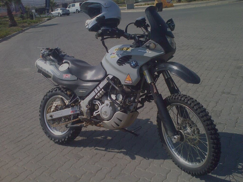

I had 2 successive accidents last year after which my plastics were looking a bit worse for wear, I stiched the broken plastics back together with a soldering Iron but the paint had also taken some damage. I then decided that the bike needs a paint job, but being as in-gat as I am, the cost seemed a bit excessive, so I started looking at alternatives... Vinyl enters stage left. I bought some auto vinyl from Maizey's and started learning a new skill (it not as easy as I thought). With some tips from RudiBlue I got it sorted, but I looked a bit bland. So I bought some stickers and went Ape on the bike  >:D >:D

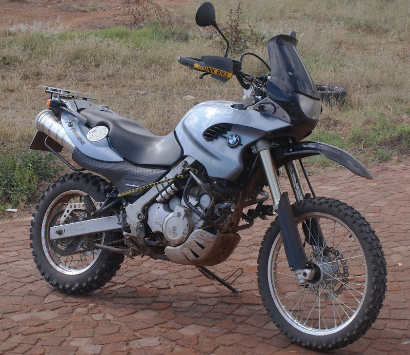

thats very zeff.... esp the colour... very HP2.
tell us about the UD forks.
Its a 2007 Yammie WR250 fork, front wheel and brake caliper, even the head bearings is off the Yammie (that is the trick, as they fit in the GS frame)
The fork is as it came off the Yammie, same springs, same damping settings (both)...
I did the change when my fork was giving me shit and started showing a crack on the bottom housing.
