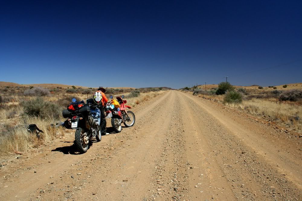

My bike is a 2003 KTM 640, which I bought new in 2004. Done 37 500 km prior to the trip.
Abel's Honda is a 1984 XL600R which has seen a hard life. Unknown number of owners, amongst them Bradleys, who had done the Desert Run with it at least once, and still brags about how he thrashed it. It has seized twice that we know of but the mechanical reliability has been good since a lot of hard work was put into it.
Abel decided where we go the first week. He grew up on a farm at Lohatlha and wanted to visit the farm where his father and grandparents as well as other family members were buried. He arranged to visit some relatives which he had not seen in 30 years.
The weekend in between was reserved for the bash and my choice of route would take us to my uncle's farm near Steytlerville, where my father grew up.
Abel did the backup for a BMW Club trip through the Transkei earlier this year and he wanted us to join them for a reunion at Cedarberg Oasis on the last weekend. We would meet them there on the Friday afternoon.
Back to the story at hand: From Niekerkshoop we were heading towards Volop. Sections of the road had terrible corrugations.
And then, about 14 km outside of town, the Honda just cut out. Dead as a Dodo.
The sun was beating down on us, luckily we know to keep hats close at hand for just such a situation.
Took the headlight cover off and found the green wire to have a dodgy kink. Cut it and rejoined it. Now the Neutral light worked but no starting. Seat, tank, side panels next. Remove spark plug. No spark. Fiddle and tighten connectors, check wires, swop fuses. Nothing. Re-assemble.
This took about a hour. I could see Abel's frustration build up. We talked about calling his friend Daan in Kimberley, but there was no reception.
I was weighing up our options. Kimberley is about 240 km away, but in the wrong direction. It was to be our destination after the Lohatlha loop. Abel's mother lives there.
So I knew there was only one thing to do. Swop bikes and let me see if I can fix the Honda.
The tow strap I had was only about 2 m long so it made for an exciting tow on the corrugations back to Niekerkshoop. We phoned Daan at about 12:00, he would fetch me & the Honda and the excess kit. Abel would travel light with spare tubes, tools and stuff for a one night sleepover at his cousin. (Little did we know I had forgotten to pack tyre levers in).
