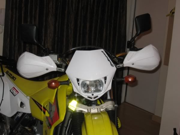

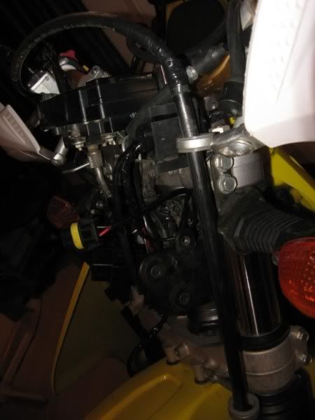

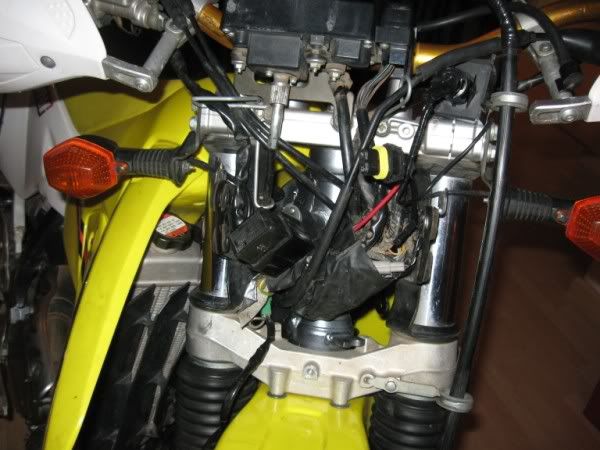

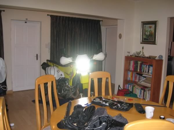

So, finally finished my HID install  :thumleft:
It took me about 2 weeks to do, on and off, I rode with the ballast taped to my speedo for a few days as well!
Thanks to Crossed-up for the all the install help.

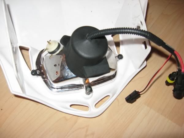

I bought a cheapo HID kit from China Town for R350.
I bought a super-cool Polisport shroud from Bus.

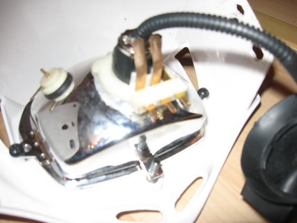

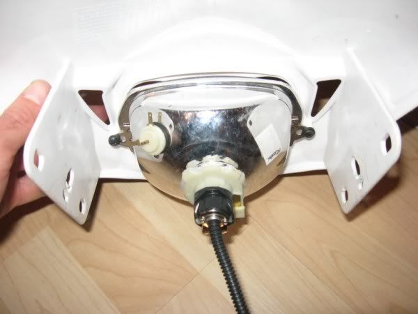

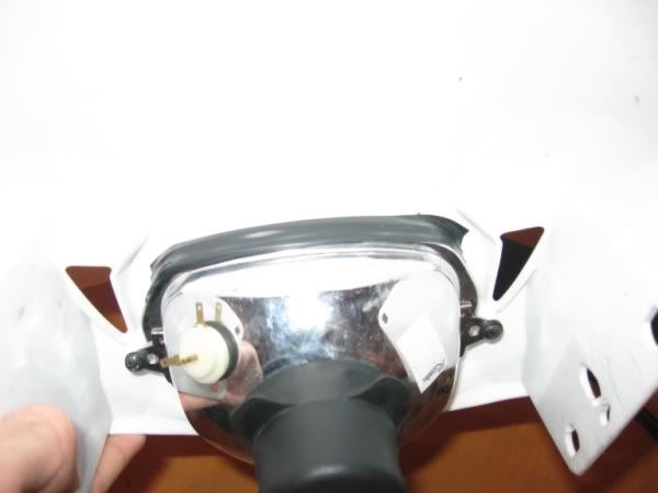

The first problem was fitting the bulb into the shroud. I used the polisport bulb holder, removed the bulb and pushed the HID bulb through the middle. Some tape and silicone sealed it up and keeps it in place :)
Another problem with the polisport shroud is it 'leaks' alot of light out the top, so at night the HID reflects into my eyes. I solved this by putting black tape over the bit of the lens that shows from the top.

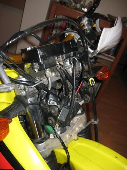

Then i had to move the wires out the way of the way, I simply moved the clutch cable to the outside of the wires and this pulled everything towards the bike (yes, I thought it was smart too, just hope it doesn't break anything).

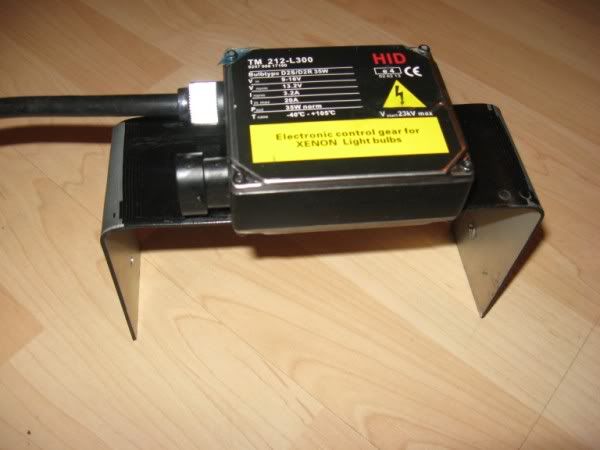

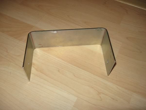

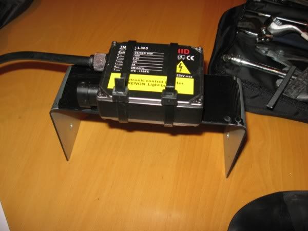

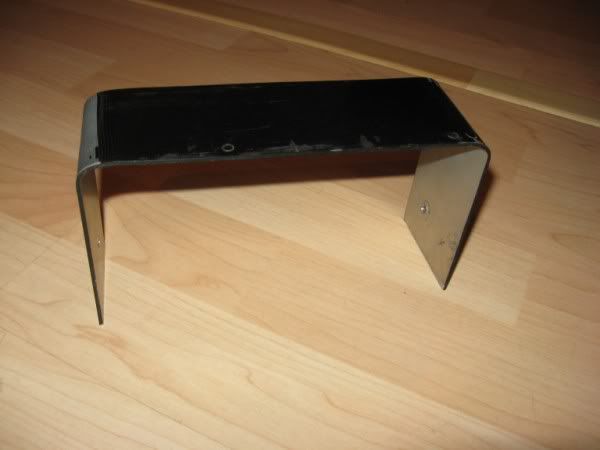

Then in comes crossed-up, he gave me a piece of ally and then helped me bend and cut it to look like this.

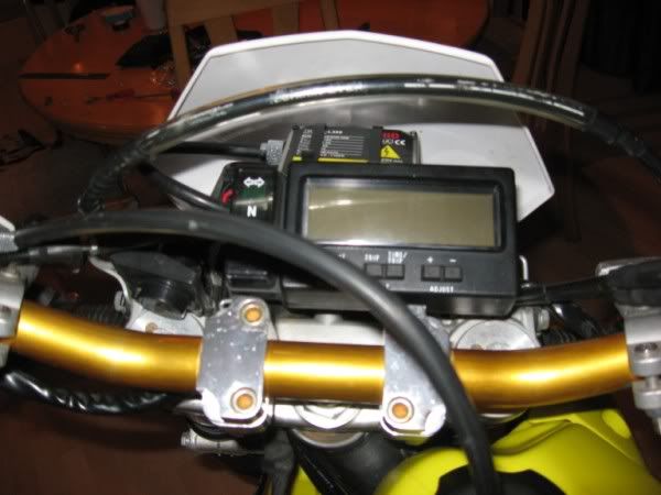

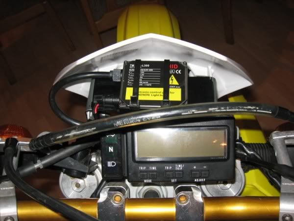

Double-sided tape and some cable ties secured the HID ballast to the crossed-up metal plate.

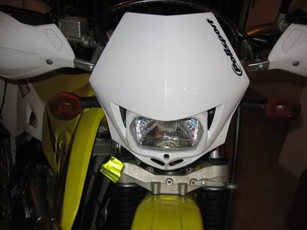

And then with some fiddling I put it all back together. See:
And that is my first real 'mod' on my bike. Yes its fairly simple to do and there are more pics than needed but it rocks :) it's KARK bright. Obnoxiously so. There is actually a noticeable difference in traffic, cars in front of me move much quickly out my way.
And here is an image of it on, it doesn't do it justice. I got a severe headache taking this picture. NICE :)

Please post a pic or two of the light in action. Down the road, against a wall. Use dim in one set of pics and bright in another set.
Will do tonight, but the difference between dim and bright is simply the angle of the light :) as far as I can tell there's no difference in light emission.
