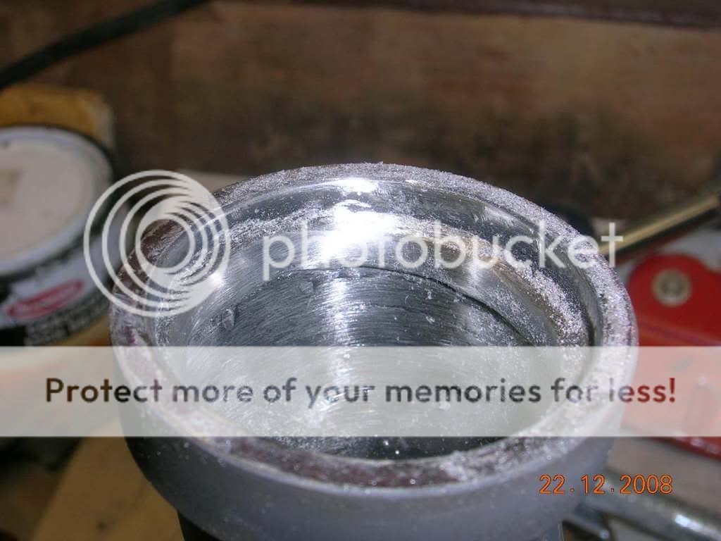

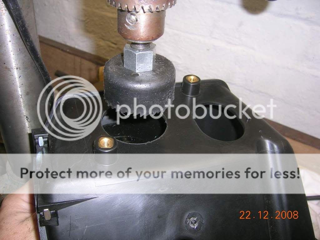

Remember my 94 DR is BONE STOCK but for a scorch pipe. But here are pics of my 08 DR ...airbox additional hole, 150 main, screen removal, header weld reduction ( note Superbike Solutions claim some degree of exhaust restriction at this point increases torque ! ) , and a Geoff Talbot pipe which is straight-through.
I ran a K&N for a while then went back to stock to not compromise my bikes longevity.
My DR against a bone stock DR of the same model belonging to my mate , leaves it for dead.
I would not drill the slide nor clip the spring , as the new DR slide has only one hole to save the needle .... as I've said before you don't want a twitchy throttle over rough stuff , I wanted more top end power and I got it, but I wanted the controlled power and economy of a stock 1/4 to 1/2 throttle.
I left the needle STOCK, it's lean yes but I tune for Hot and High and want range and economy when not racing at full throttle.
There is a flat spot during warm up to remind me I have mods , and also to ride like an intelligent person before optimum running temperature !

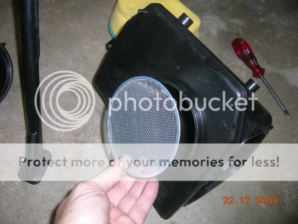

Re the wire ring in the clutch: It's not continuous but rather some sort of a very flimsy circlip. Chances are good that it will give you hell when you try to fit it again (it gave me hell). Just throw it away as I did, no adverse effects noticable.
In theory I think it prevents the two washers from dislodging and causing some sorts of hassles which I don't think is really possible with the clutch & engine assembled & running. Might be a factory assembly line thing. (?)
Removing the mesh screen is not really advisable since it's the only thing that stops your engine from ingesting stuff (big stuff) if the air filter tears or is poorly fitted. Also prevents backfire from scorching the filter.

I am now aware of the screen as a backfire damper , and also read there is NO data suggesting screen removal adds any performance, if I did it all again the screen will stay.
I did a screen removal on my KLR back in 08 but that LOOKED restrictive ! ???
I am now of the school that a little top end breathing never hurt anyone , as we live in a country that tolerates aftermarket pipes , so why not ride a BIKE and not a goddamn sewing machine , but for the rest , ( oh my God am I getting old ??? ) ....stock works man ! If you wanna go faster get a faster bike !!!

Thx for pics Veemax. AFAIK dynotune with dynojet kit, increasing airflow - would not necessarily increase fuel consumption. Will have to see I guess. I want extra oomph on my old thumper, as much as is possible without causing reliability issue and/or high fuel consumption.
What mods would affect reliability would you say?

This is the advanced R&D WC airbox mod with Geoff Talbott intermediate pipe (arriving in about two days) 155 Dyno Jet main jet and needle
