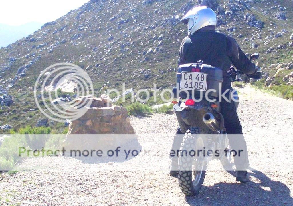

Er. Hi ! Been away RIDING , just clocked 12 stunning passes, stitched by 2000km, with the Missus. I took the new DR because it's happy at the lower speeds of my wifes bastard XLX350R. Was a good call , you can't thump the Old DR , you gotta REV it ! I reserve the Pre-96 for hanging with the big dogs , it never ceases being fun to humble a modern bike with an oldtimer .... >:D

Here's a tip , my 110mm PVC pipe luggage system I just finished testing over 1962 km / 12 passes ride on my "new" DR worked so well I'm going to build more like it for the "old" DR , which so far has no luggage system barring a tank bag and soft bag + bungies etc.
My plan was to carry water low low down behind my left knee , to put the COG in the right place , that worked brilliantly , one shorty tube mounted onto the stubs for the left passenger pegs

what an awesome pic! we share the same sentiment. To do a trip however, would mean that we'd have to make it worthwhile for all of us - staying so far away from one another. In other words, it better be a good and proper trip. I was thinking perhaps to  do a trip up Namib and come down through Botswana...in august. But I mean that's just an idea. If there is lekka local routes that we can explore that would be an option too. But the idea for me is like 80 plus percent gravel and even technical, sleep in tents wherever, have lekka braais and beer at night, strong coffee and rusks in the morning and RIDE! i want to see the toughness so proclaimed of the DR myself!
