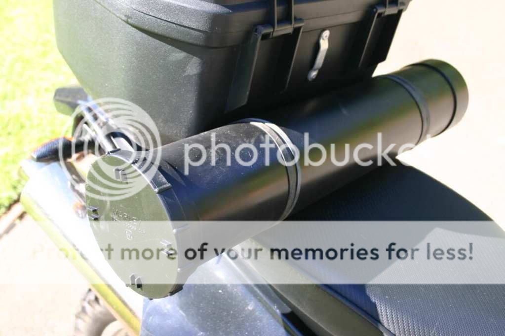

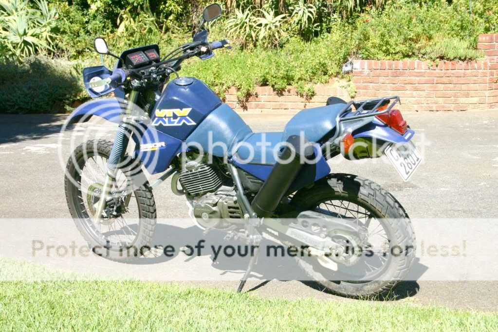

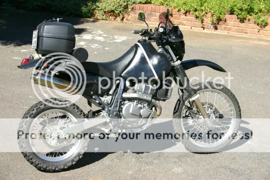

Been gone a while ... did fetch that Cruiser from Benoni, and was a good buy . Anyway , while you lads have been busy I've been preparing the wifes bike and ....which DR? .... the new one won the vote ,( better seat mainly, and it's better riding slow )
So I mentioned this idea of using 110mm pipe for storage , check it as applied thus far. I hate panniers, but this pooratech fix adds significant storage in the right place for weight ... won't catch much wind, is dust and rain proof, and very light.
Anyway, had fun with it ....
You can see the bike I created for the Missus's short legs , a dual sport bike with suspension that weighs nothing, and has a seat height of 700mm, and can manage highway speeds ... a tough call eh !
So here's a novel luggage idea for the minimalist : ) .... PS Ceres fruit juice concentrate bottles are the perfect snug fit ...
(Tiger1050/DR650SE/DR650ES/VS800/VZ800/LS650/XLX350R/GN400-tracker/YZX200)
