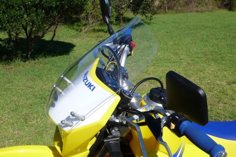

The work continues - fitted the Dakar screen Topbox very kindly brought along to the Breede bash - gives courier service a whole new meaning ;D
I cut some ally tubing to act as spacers between the cowl and the screen. Made the top ones longer so that the screen "stood up" more, giving me a bit more protection. Still need to get some SS hex head bolts. Since these pics were taken, I've shortened the lower spacers even more which help, angling the creen up even more. The screen takes all the wind off my chest when on the tar and there's hardly any buffeting around my helmet at all. It does shake a bit on badly corrugated roads, but I dont think it will break the mounting points.
By mounting the screen away from the cowl, I've created a space between the 2 that allows some air to flow between them and I think this is what creates the lack of buffeting.
Also fitted the GPT rev counter - really easy to do.

My few cents worth. I think that your screen mountings are to close together (top and bottom) and with time either the screen will crack or the cowling around the headlight. All off course as a result of vibration.
I agree, I had mine setup like this and the headlight plastics take too much punishment. I bought some handlebar screen mounts from topbox and now it's solid as a rock. Will see if I have pic somewhere

I've been aware of this and am thinking of making up 2 ally arms to stop the movement.
Thanks for the feedback.
