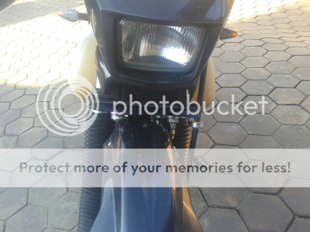

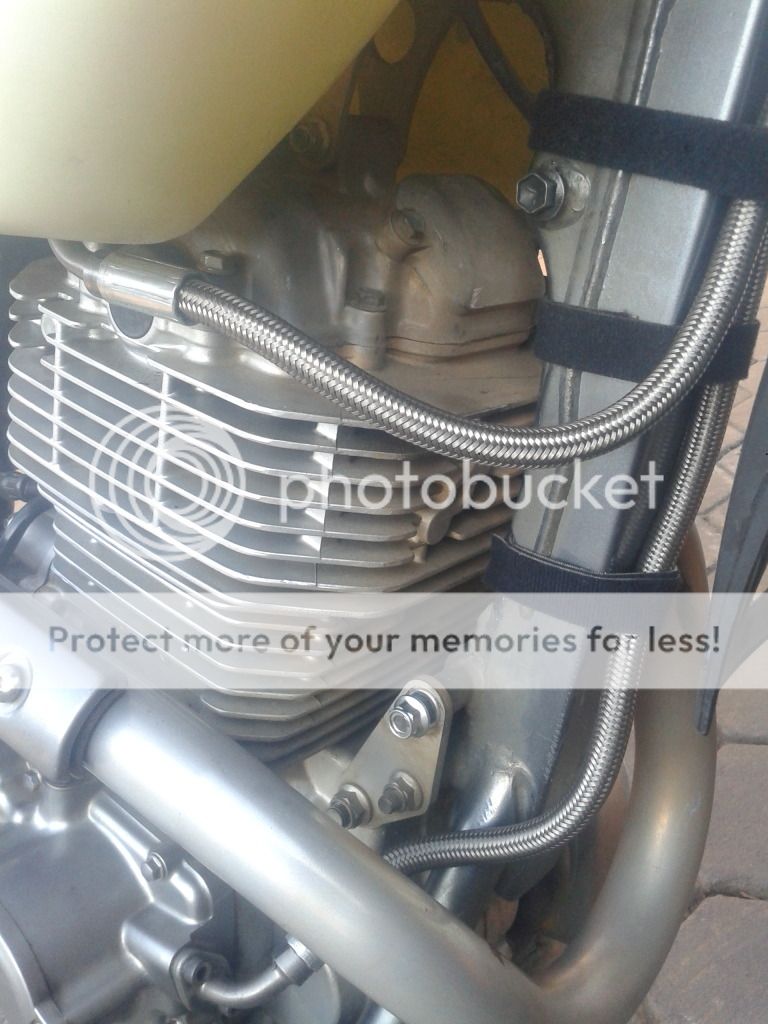

Hi 2wd
I put a new oil cooler on top of my front mudgaurd, exactly to avoid this problem ( and some other ones). Looks great and works very well. I have been planning to do a writeupp about the mod but havent had time and I am a lazy dude.
I still have my old one, but would advise you to redo the whole thing the way it should have been done initially. Cost was about R1200. Here some shiity mobile pics, in real life it looks great!!
Better airflow over engine, and a lot easier:
Project not finished, doing some testing. will do a writeup when done. no will do a quick writeup in about 10 min.

Thanks pielas. I was thinking about cool ways to mount it. But all I could come up with would end badly. But the oil cooler would be a more comfortable seat than the stock seat...
