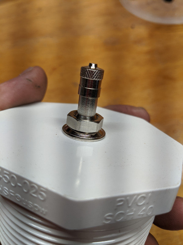

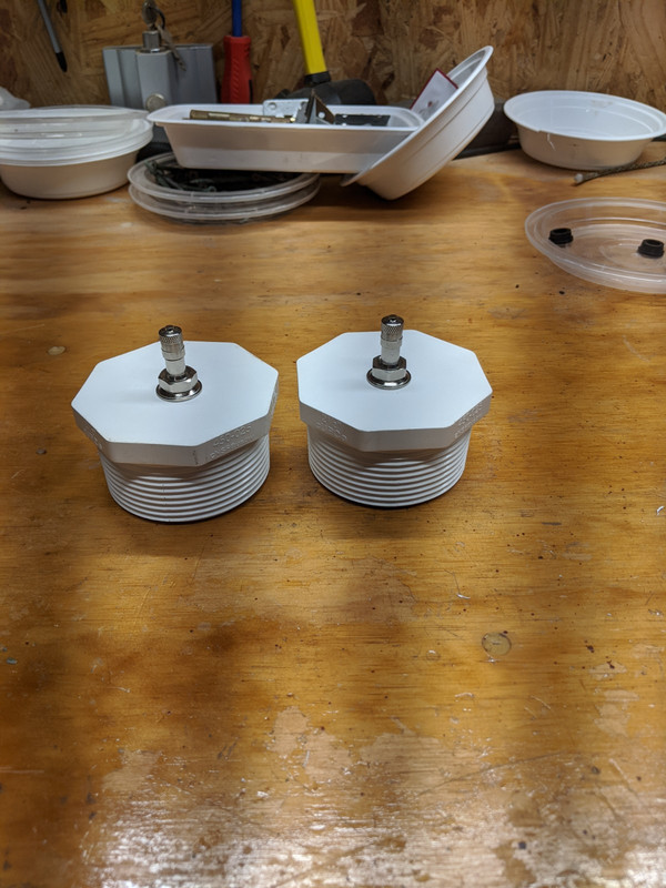

I have saved several used water softener tanks the last few months. Today while at a plumbing supplier shop I found two 2.5 inch plugs with the correct thread to screw into the top of the softener tank, both cost me $5.25  :thumleft: Less than half what I would have paid at a regular outlet like Home Depot.  :deal:  On the way home I stopped off at the local tyre shop and enquired about "bolt-in" tyre valves. They took me out back into the workshop and found a couple still new in their box. Gave me the two I wanted, FREE!!!!
So... here is my evil plan to take over the world water; I will attach the valves to the 2.5 inch plugs, then screw the plugs into the softener tanks. Then I will inflate the tanks to around 20 - 30 psi to make them nice and firm and rigid. Then I will attach the tanks to the sides of the boat, sort of like outriggers, but against the sides of the boat. This should stop the rocking  :sip: :lol8:

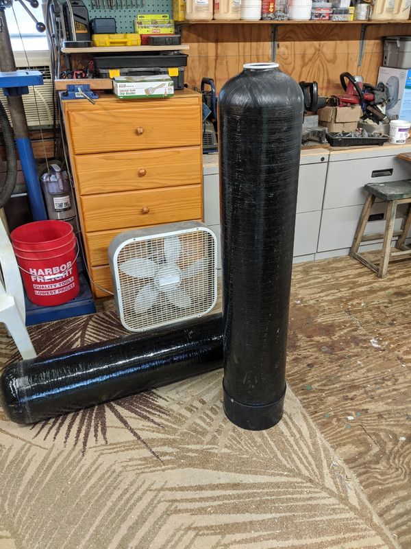

Here is a pic of the two tanks selected randomly from my stash
And here are the two plugs, bolt-in tyre valves already fitted  :biggrin:

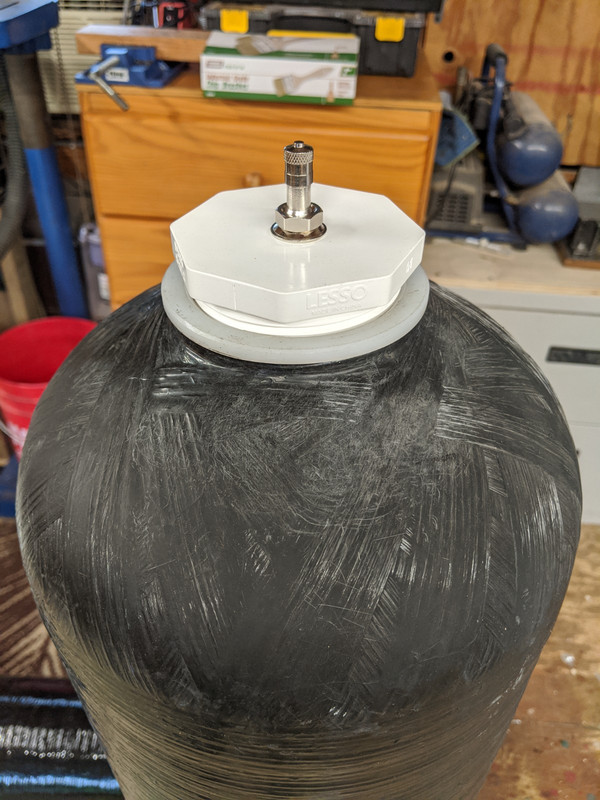

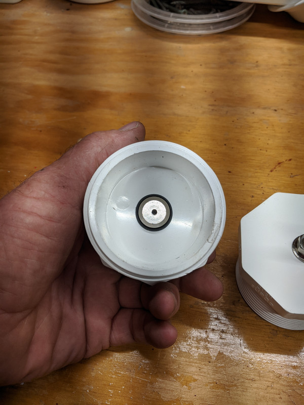

This is where the plug will screw into the tank

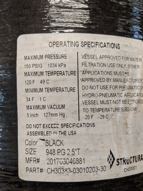

and the spec sheet sticker on the tank
As you can see, the pressure I will be adding to the tank is well within its limits. I will also give both tanks a coat of epoxy just to make sure that the wrapped fiberglass is properly sealed and secure, then I'll give them a coat of paint to better match the colour of the boat. Minor details like exactly how I am going to properly secure the tanks to the boat will be figured out later  :peepwall:  :imaposer:
So now a question for the clever okes; will the tank be more buoyant if I add more air (pressure)? If I just add say 10psi, then it will definitely work, but if I add 40psi, will it work better? My guess is that more air equals better buoyancy? Let me know please, I'm just a dumb plumber remember  :pot: :peepwall:

No, the bouyancy is directly a result of displacement of water, not air pressure.  :sip:
Correct, the buoyancy is dependent on the depth at which the tanks sit in the water (the volume of water which is being displaced).
You don't have to "inflate" the tanks, they only need to be water tight  :thumleft:
The challenge will be to get the exact height at which to mount them relative to the free board, and if you want to be able to remove them, to have a sturdy mounting system.

Those canisters are going to look like booster rockets
Those cannisters would stabilise a much bigger boat than your Jonboat !
