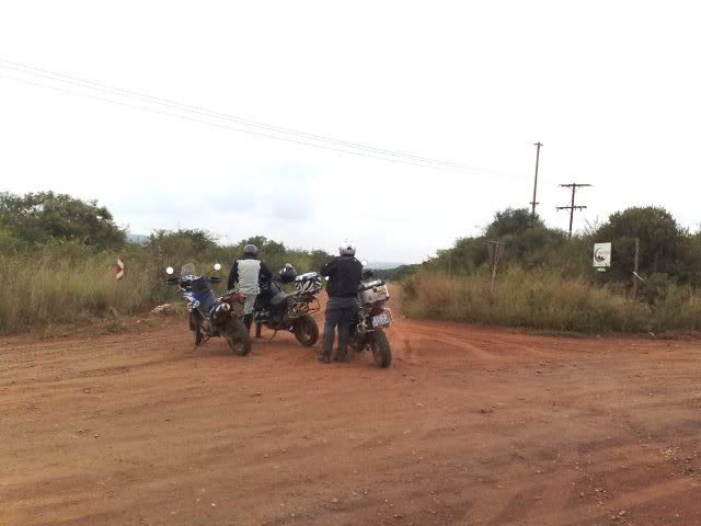

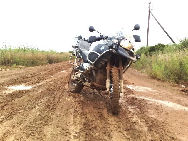

I had my chance to test the new wheel on a trip towards the Koster area.  In the group, seamus on his dakar with knobblies, Pierre on his GSA (same as mine) with anakees and normal front.

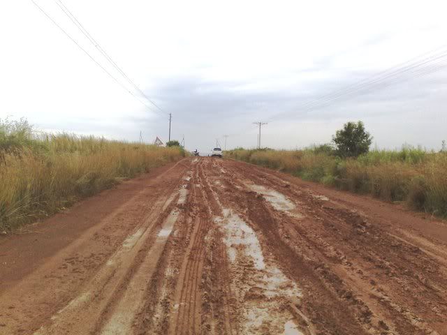

It had rained in the night and we hit the mud soon on the ride...

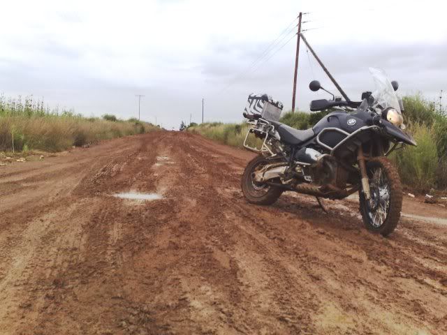

Gooie sticky and normally a nightmare of slipping and sliding, instead the new wheel floated along, moving easily wherever I directed it, giving me huge confidence.
Pierre meanwhile was cursing us, not least cause I went down the wrong muddy road but he was all over the place on his standard front!Thats him in the far distance struggling along.

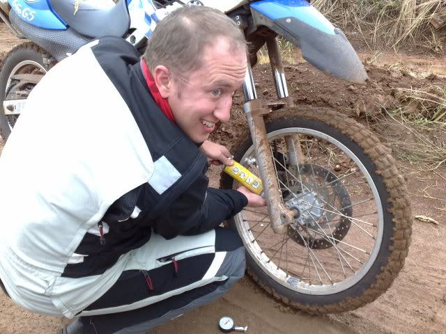

A short while later Seamus got a puncture and we headed home pumping his front every 20 or so k's.
On the way back Pierre and I swopped, to get an immediate impression.  I also gunned it on tar doing some fast 150k twisties. Verdict..
1.  On gravel and loose sand its fantastic, Pierre got on my bike and imeadiatelly flew along where he had been taking strain.  His comment - this rim makes you too confident you could get yourself into kak!
2.  On mud and dirt the wheel is solid, confident with crisp turns and seems to float, but with added traction.
3.  On tar (I am not a peg scraper by a long shot) it feels very good, if anything a more positive action (more counter steer) is needed on sharp corners.
4.  I rode with no mud flap , on dirt this is fine but on mud the wheel throws the mud forward and the wind lifts and sprays this into your face!
