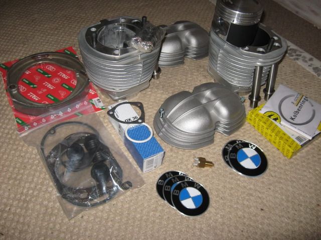

I am planning a full engine rebuild, replacing the R80 barrels with the 1000cc Siebenrock upgrade kit.
This is a bit of a compromise. I would have loved to go all the way and build a 1043cc Mahle rally motor but my pockets are not that deep :( The Siebenrock conversion, if it lives up to the hype, should provide a boost in low down torque without a major increase in fuel consumption. I decided to throw in the HPN high torque cam and oil cooler with thermostat just so the bottom end is ready for the Mahle if I ever decide to go that way one day  ;)

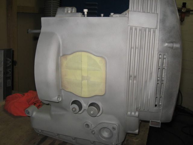

There is lots of work still to do on the motor though. The casings have been sand blasted and then glass bead blasted, a technique Altus has developed to give  a better than new look.

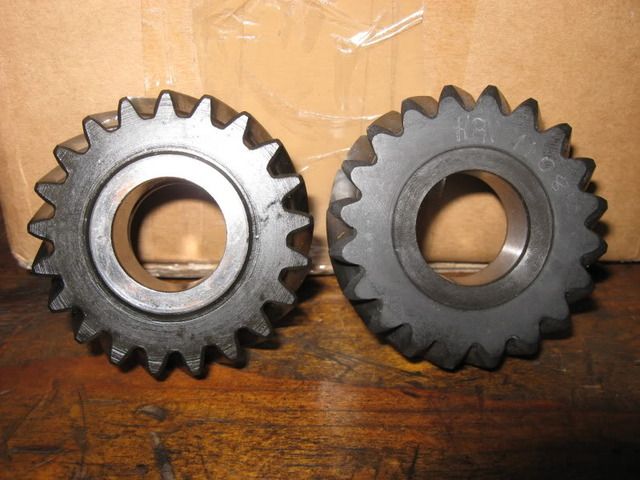

The gearbox was complete this week. I am using a box that had the full G/S Workshop restoration treatment about 14000KM back. All seals and  bearings were replaced so there was no point in redoing that. What we did do is open it up to fit the longer 5th gear. I am keeping the standard GS diff which has a shorter ratio than the R100. This should give great performance in the lower gears but I wanted to drop the revs when in top gear. The one tooth difference gives about a 5% reduction in the 5th gear ratio, so 5% less revs for the same speed
Standard on the left HPN on the right
The gearbox is one of those "dont try this at home" jobs. If you want to do it properly there are a number of special tools that you need to get it all apart and  back together properly. Fortunately there isn't a special tool made by BMW that the G/S Workshop doesn't have  8)
220Nm for that nut on the output shaft  :P
