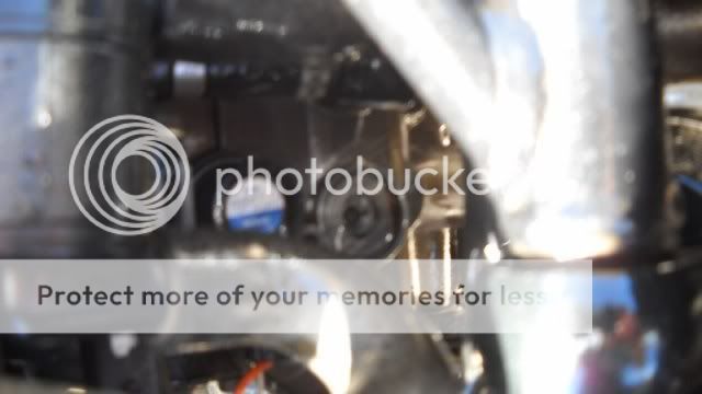

On closer inspection, I see one of the cylinder head collar screws is gone.
luckily I catch it before too much oil is out.
I stroll up the road hoping for the impossible but don't see the bolt, just patches of oil
I think a bit about climbing a mountain for cell reception to phone for back up, but really don't want to.
I don't mind the climb, but I hate the thought of parking of for a few hours and then going home with my bike on a trailer.
I clean it with petrol and stick some duct tape (essential in any KTM tool kit) and switch the fans thermostat bypass to keep the engine cooler, thinking "I have a spare litre of oil, if it spurts again I'll pop in at the nearest farmer and make a plan."
Decide it's a good time to have lunch before I head off again.
The patch lasts about 5km before I get some more smoke.
I stop on a bridge and open it up again.
By now some of my lunch has worked it's way to my brain and I'm thinking a bit clearer
I find another 6mm bolt with a flange, I'm not happy with the size of the flange, but it's the best I've got so I remove it as there's more bolts and a seat holding that piece of plastic in place.

Hey Thump sounds like you are really enjoying your KTM , do you possibly know why this bolt decided to say cheers? have you personally been working on your motor if so do you think you did not ighten it correctly? Great pics I have just retired and I am planning on a trip to Nambia and possible Tanzania through Zambia  :thumleft:
Yes, the hole thread is stripped, the temporary bolt I put in only had thread for the last two turns, the start was quite smooth, so although it held before (the torque settings are very low) obviously not enough. I'll have to make a plan with all of them for peace of mind.
