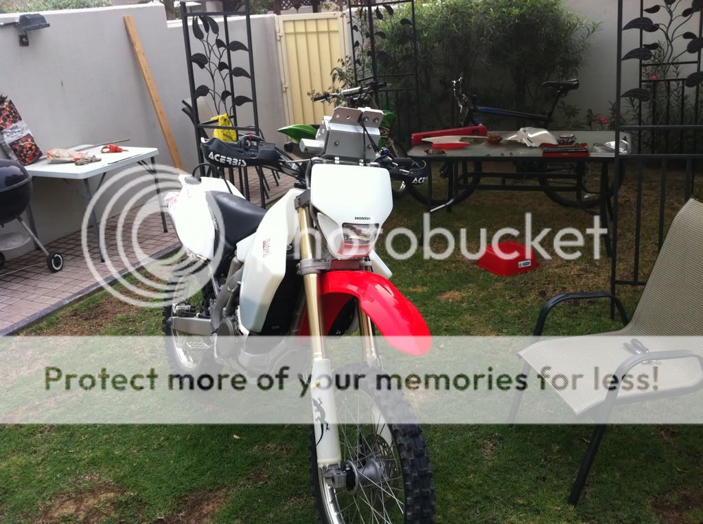

Part 2 : The Bike
I have opted to use my 2007 CRF 450 X which has previously done the challenge with Englishman Chris Jackson as the Rider. Although the bike has done the challenge before I did not get all of the Rally equipment with the Bike when I bought it from Chris.
There have been a number of things that I needed to get here is the rough list:
1. Wheels – I have opted to buy HAAN rims with has a Cush or Cushion drive built into the rear wheel
I chose these rather than the Talon Rims as the Cush drive seems to be better built. I have bought the set of rims from Gecko Motorcycles here in Dubai.
2. Tires- I have opted to get the Metzeler 6 Days Extreme tires which are FIM homologated. I imported these from Guildford tires in the UK. Nice bunch of guys and really willing to do Business.
3. Bash Plate with Water Tank – I have gone with Force accessories bash plate with built in 3 litre water tank for emergency ration as per the FIM regulations. I imported this From Force in Australia.
4. Exhaust – When I bought the bike it had a Yoshimura Exhaust. It was how ever missing the low noise insert which I managed to get from Yoshimura RD in the USA.
5. Engine – After speaking to everyone and getting their thoughts around the Engine I have decided to rebuild the Entire motor. So I have ordered basically everything except the casings for the bike. Time permitting I will include a post or three about the Bike Build including the Engine Build.

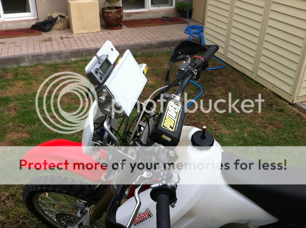

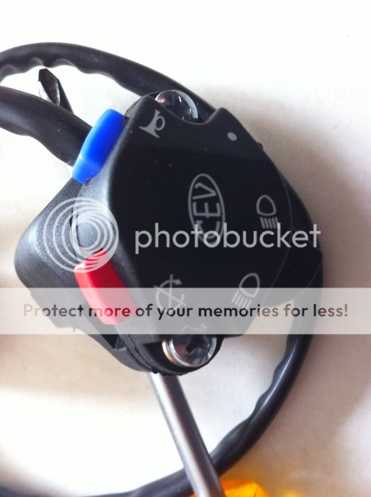

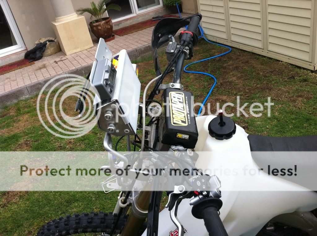

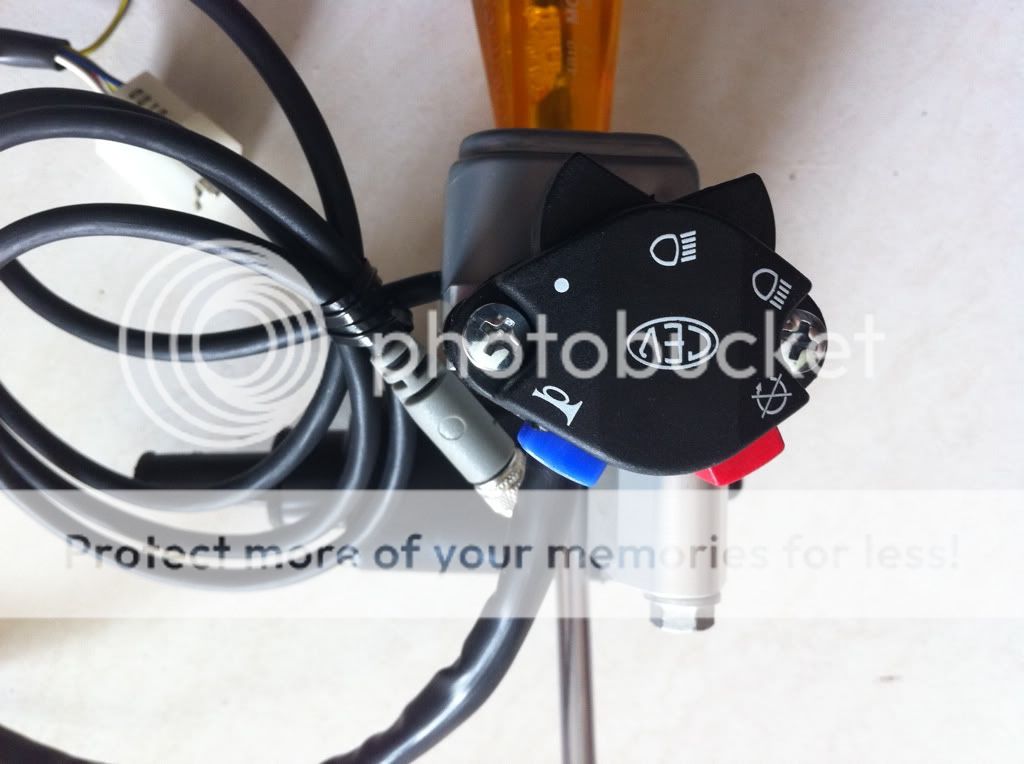

6. Road book – I have bought the MD Road book which is made by Marco Delapagne. After a long search I made contact with Marco who in turn suggested I buy the road book through Rally Raid Services in the UK. Along with the road book I Ordered the Road book ICO bracket as well as the Switch.
7. ICO – I found ICO in the USA and they were willing to supply the unit to me.

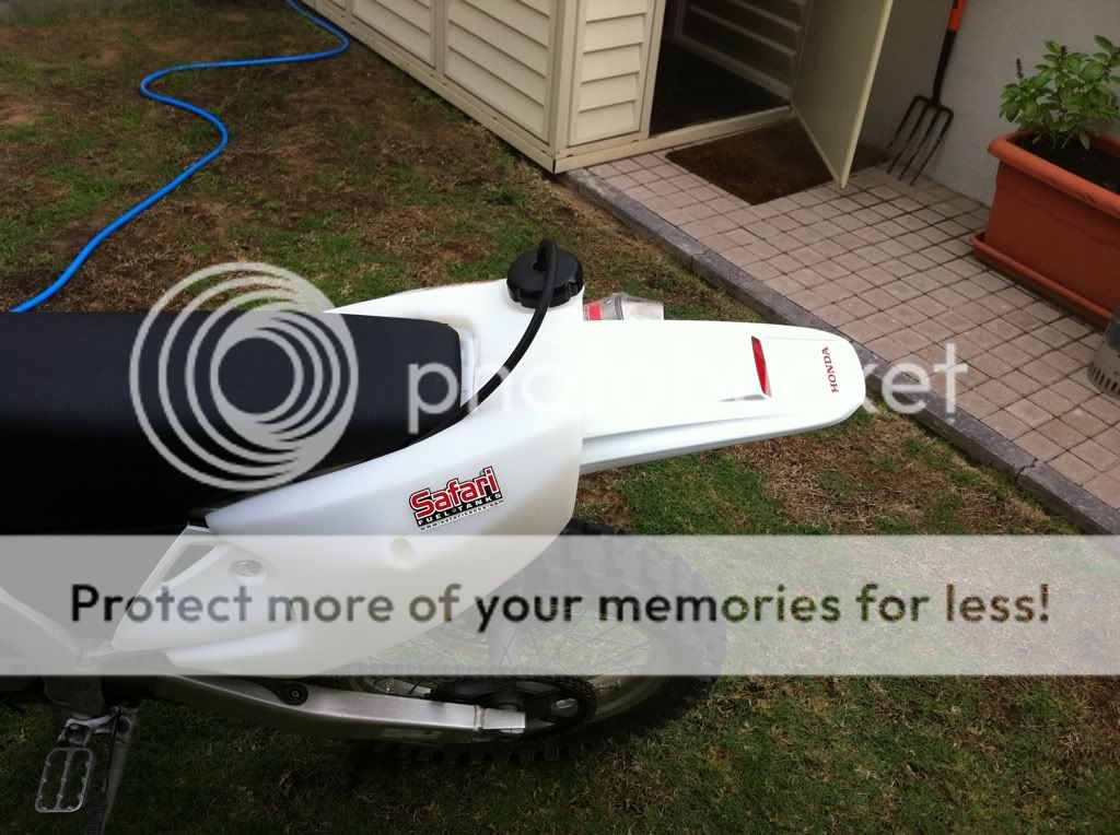

8. Fuel Tanks – I have decided to buy Safari Tanks from RV Aqualine in Australia. I opted to get the 21 Litre front and the 8 litre Rear tank. I hope that this balances the bike a little bit.
9. I have bought Renthal Sprockets and a D.I.D  Chain.
