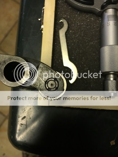

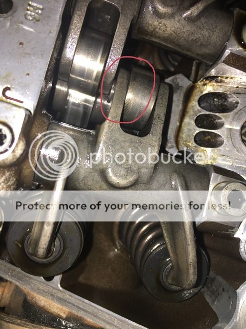

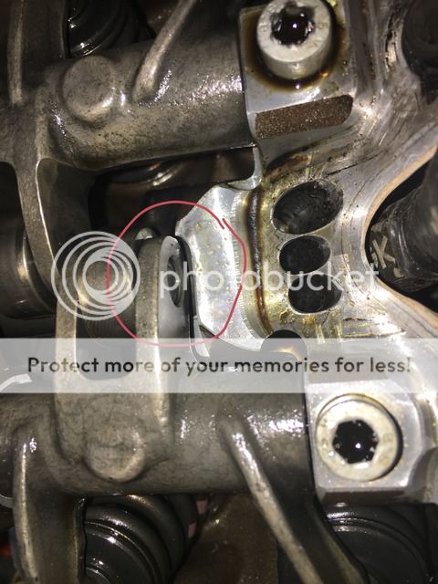

I decided to check valve clearance on my 690 in preparation for my upcoming trip to the Koes rally. The outlet valves was in spec while the inlets were below the minimum clearance and had to be adjusted(re shimmed).
I noticed that the roller shaft on the inlet rocker arm have started to come out and that there was rubbing marks on the side of the exhaust valves rocker arm. When I removed the rocker I could with some effort push the shaft in and out with my fingers.
I strongly suspect that if the shaft come out far enough at the right time it would hook on the top of the other arm and that this could be one of the causes of rocker arms breaking?
The roller bearings did not have any play so I decided to just pin the shafts of both rocker arms to prevent them from coming out again.
Now to see how long my fix is going to last.
PS. If I ever have to buy new rocker arms, I would pin the new ones before installing them!

Well spotted and I think your fix will last.

If my research is correct thats exactly why they fail.and that was also the recomended fix

Exactly what happens before they go bang. Rocker arms made after 2012 are pinned differently to be more secure. They still fail though. Please report back if your fix do last.

I used a center punch and gave it a good wack with a hammer on the edge where the shaft meets the rocker arm. Did it on both sides
That is the 4 little dots around the shaft in the last photo
