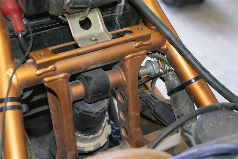

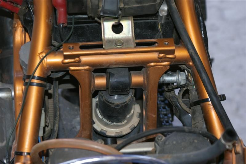

Ok so today I was doing some maintenance on Glen's bike, oil and filter change, clean air filter, check valve clearances etc and I thought why not take out the carbs and give them a service too. Upon removing the airbox I found this.. :o

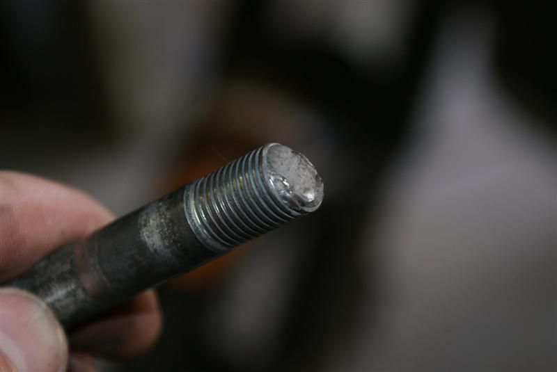

I thought wow ok I'll just turn it back in and all will be ok.. But as much as I turned it wouldn't tighten. On better inspection I found that
the end of the bolt with the nut had snapped off..
What cuased it? I dunno. How long was it like that I dunno but all I can tell I'm very lucky and judging from the condition of the bolt it had been like that for quite a while already... It seems all that stopped the bolt from falling out was the bit of wiring harness behind the head of the bolt..
Luckily amongst my stuff I found a 12mm bolt in similar length and fitted it with nylock nut.
All's well again and took her for a test ride this afternoon..
